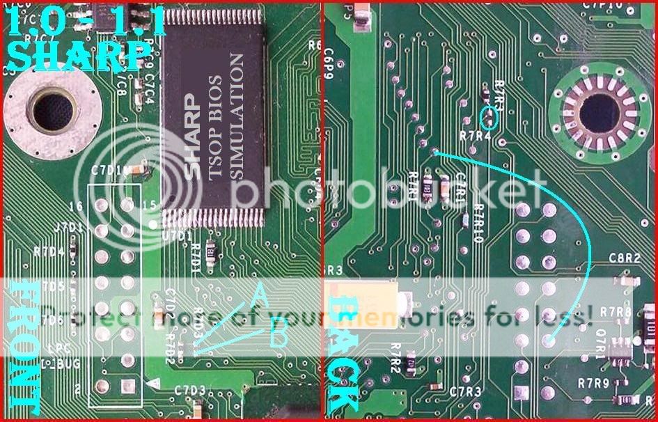

HERE IS SOME PICS OF THE ENABLE POINTS
PIC 1: 1.0 - 1.1 TSOP ENABLE POINTS (NOT FOR SHARP TSOP)
PIC 2: 1.0 - 1.1 SHARP ENABLE POINTS (ONLY FOR SHARP TSOP)
PIC 3: 1.2 - 1.5 TSOP ENABLE POINTS
cool.gif - ENABLE POINTS FOR XBOX V 1.0 - 1.1
(DONT WORK WHITH SHARP TSOP)
1 - JOIN THE TWO POINTS ON THE BLUE "0"
(ONE ON TOP OF THE MOBO AND ONE UNDER)
2 - THEN FLASH
cool.gif - ENABLE POINTS FOR XBOX V 1.0 - 1.1 WITH SHARP TSOP
(SORRY... I DONT FIND A TRUE SHARP)
1 - JOIN THE POINT ON THE BLUE "0"
(UNDER MOBO)
2 - JOIN THE WIRE
(UNDER MOBO)
3 - USE TWO LONG WIRE ONE ON "A" AND OTHER ON "B"
(TOP OF THE MOBO)
4 - TURN ON THE XBOX AND WHEN YOU ARE READY TO FLASH TWIST THE WIRE "A" WITH THE WIRE "B"
5 - NOW FLASH
cool.gif - ENABLE POINTS FOR XBOX 1.2 - 1.5
2 - NOW FLASH

just so people dont get confused. On a 1.2 - 1.5 you only joint the two points shown on the FRONT (or top) of the Mobo. I think this is what the poster said, but when i read it, I had to second guess. I think he meant front as in the front of the case where the power button is, and back where the fan is.

sorry... im not to good at english...(i speak spanish). i forget the word "top" when i was doin this one!!! i hope this can help people of the scene!!!

1.2-1.5 doesnt have bottom points?

there is one set of obottom points, but the are identical to the second top set, so tehres no point in bothering with them

I have modded a few 1.0's and 1.1's and I have never needed to add the little wire on the bottom from the lpc to a joint. I just solder the spot on the top and I solder the two joints beside the screw but the wire. I have never used and I mine have been working like a charm. What's the purpose of the wire? Anyway Later

That wire is only necessary for people with SHARP TSOPs. The SHARP TSOP requires more power to be erased and flashed.
