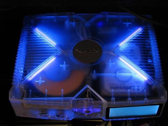

...... sry if it doesn't work....anyways as you can see in those photos there are cathodes on the dvd window, jewel and the ront panel of the xbox with only one inverter that i can see...How can you do that? Becasue they are not using led which is what i know....Please help if u can thanks.

I simply took two apart and combined them, takes up as much space as one:

Take two converters and pry them open. Take out the boards and put them back-to-back like the pic. Put them in one of the blue tops. (I cut off the front end on them so the wires could fit better. Then tape them down using electricle tape. I havnt had any electric problems so far, so its pretty safe.
