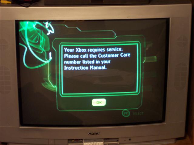

My xbox worked fine until last saturday. I watched a dvd, then rebooted it and tried to play a game. It booted to the MS dashboard and came up with a screen saying something to the effect of that my xbox needed repair and to call MS. This was with my mod chip (xecuter 2) turned off. The game was not a backup.
So I turned off my xbox, and turned my mod chip on booted it back up. Evox loads fine. I go to launch games or apps, and it takes me to the loading screen then back into evox.
Any ideas on what's happening?

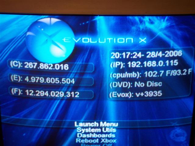

Check to make sure that your E: partition has at least 800Mb of free space.

What was the error number in the top left hand corner of the error screen.

E partition has more than 4gb free. I tried putting the game in, turning it off, and then back on again. I get the same error. I have noticed that it boots to the ms-dash fine with no error if there is no disk in. I can go in and mess with all of the settings. Once I put something in the dvd drive i get the error message. I took a picture of the screen it gives me:
Here's my evox screen, it shows my partition space:
I don't see an error number. See the screen shot above, I might have missed something.
