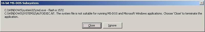

attempted to flash today, and hit the following error
it passes the first stage, but gives me this at the second and won't go further.
drive still seems to work ok in 360 so guessing it's not totally fubar'd
any suggestions?

Try it in Windows Safe Mode.
Otherwise, you have some "spyware" or "hijack virus" on your Computer which is causing the problem.
Suggest running "Adware Personal" by Lavasoft and "Hijack v1.99" if still having problems.
Also running any DVD programs in the background like Daemon Tools or AnyDVD, etc. can be a problem.

rather than spend ages sifting thru HJT logs i slapped all the bits in one of my non-browsing PC's
thanks for the support, and many thanks for your hard work on the flasher.
