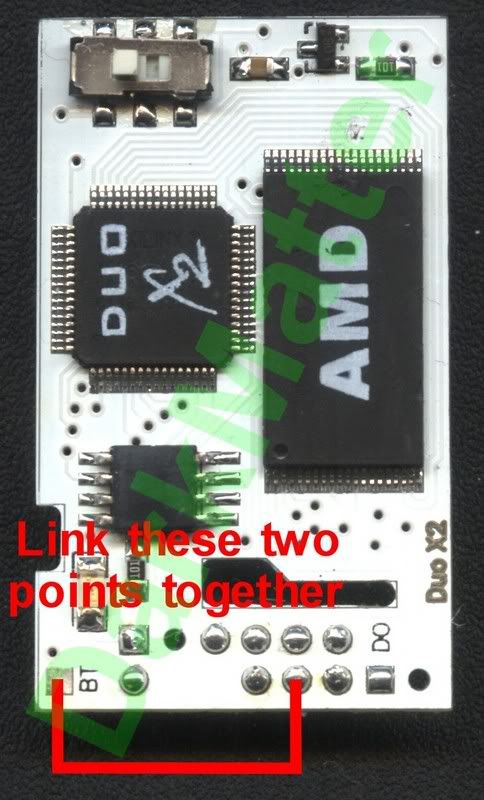

When my P/E board won't recognize the eject button work due to some lifted pads and broken traces? I can use the power button but that disables my modchip (DuoX 2) and therefore runs the stock BIOS with my modifed harddrive and won't actually do anything. Any suggestions?

fix the broken traces.

Check the picture below.
You need to remove the BT point going to your mobo and link it as shown in the pic. But obviously make the link short.
Linking those two points will allow the Duo to be on all the time. i.e. You won't be able to boot to the M$ dash, other than through EvoX.
