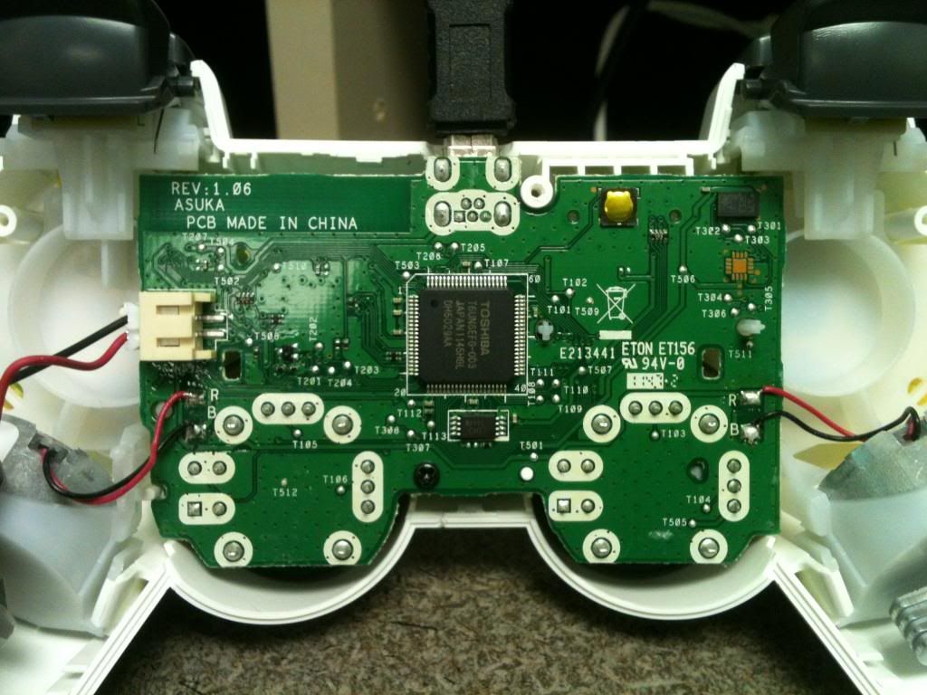

RDC,
My staff ran across two "Rev 1.06: Asuka PCB Made in China" circuit boards this week, when we expected to see VX5 circuit boards. These were wireless PS3 controllers that were ordered using the latest Sony SKU# 99013 for white wireless DualShock3 sixaxis controllers. Staff sent me a phone camera picture by text message (attached below). I am leaving for a vacation in Hawaii tomorrow, so unfortunately I won't be able to take hi-res pictures or even put an oscilloscope onto these until I get back on the 23rd.
By the way - thank you for posting the VX5 board scans and pics of the modified battery. I'm ashamed to not have contributed board scans for the VX5 when I got my hands on one early.
TAKE A LOOK AT THE JOYSTICKS. Sony returning to the "three leg" potentiometer type joysticks to save money?
