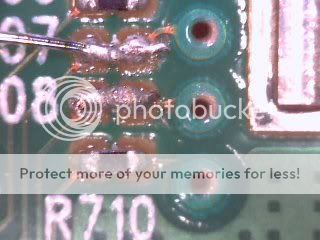

When soldering the two resistors on the lite-on drive do you just bang a bit of solder to join the two solder points or do you need to solder kynar wire to both the solder points? First time soldering so I am not sure.

I use kynar wire you could use a blob of solder but I prefer the kynar wire
I tin abou 1/2 inch lenght with solder put across point press iron on top of wire takes couple of seconds
then cut off

i just use solder
and you only need to do the one not the two
