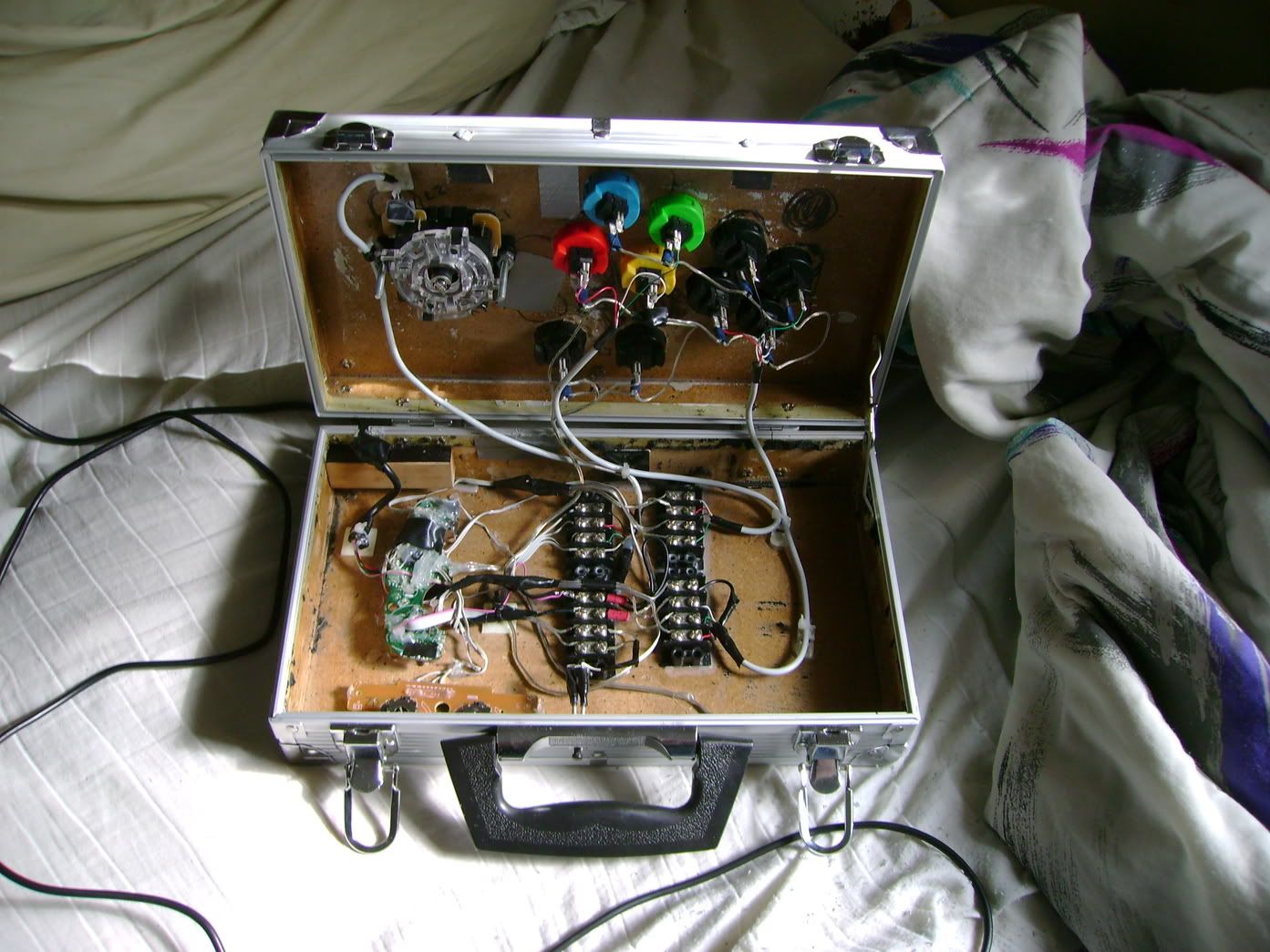

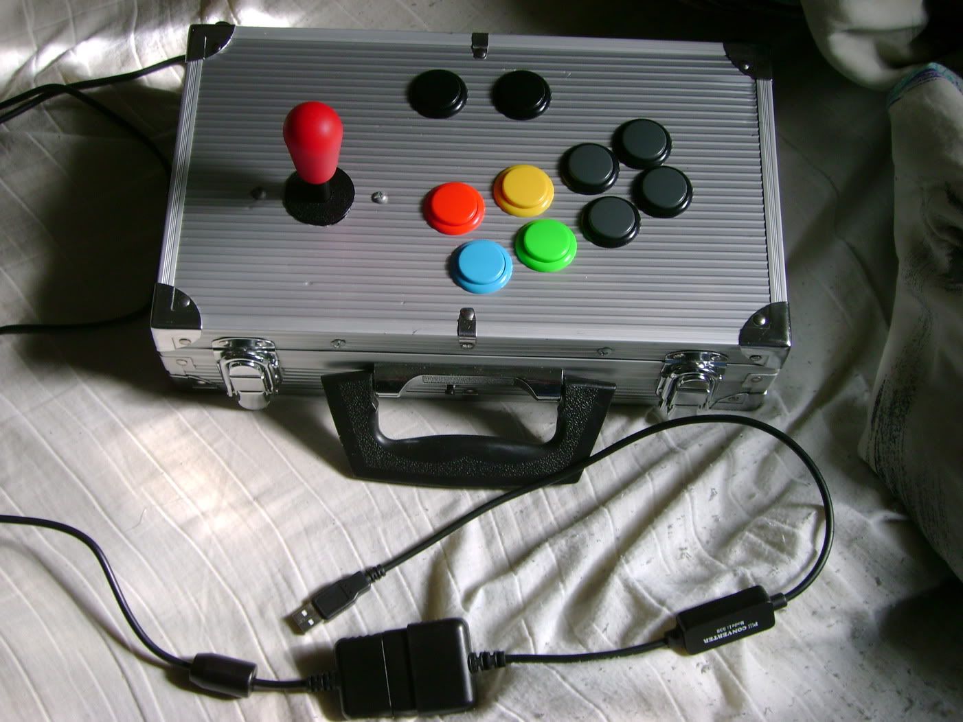

I know this might of sound like a cheat, but what I did for a arcade controller was to wire up the stick and the buttons to a PS2 controller. And then connect the controller to a PS2 to PS3 USB adapter.
I used a cheap Game Stop brand PS2 controller for the board, wired the thing to an arcade joystick and fire buttons. I am sure you can search online for PS2 to PS3 USB adapters.
Not as elegant as using a actual PS3 controller but it works, My arcade controller also works on a PC using the same adapter.

I built my own arcade controller, cost me a total of $75, and that includes all the parts, glue, electric tape and some of the tools. To be fair, I may as well post pictures of it so I would not look like I am all talk and no action. Maybe if I took the time I could so a write up for it.
My Custom Arcade controller with PS2 to PS3 USB adapter
Open case pic of my controller. FYI, that white stuff is hot glue.
