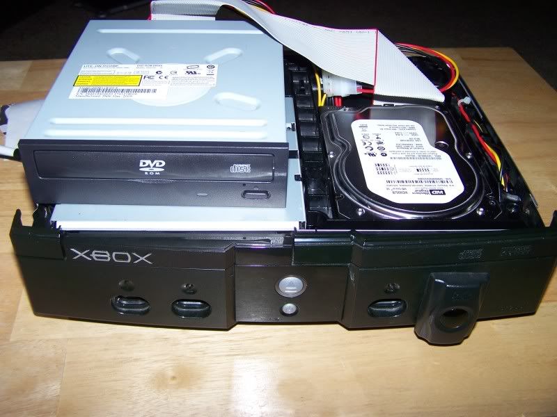

new cd/dvd drive and HD in. niether is mounted permanently as im unsure what i want to do with the case. the borked original drive is still in there atm.

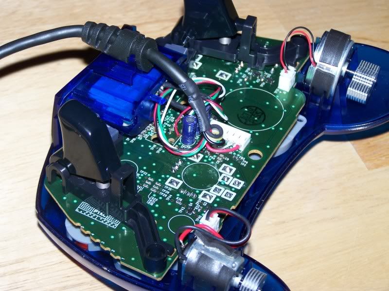

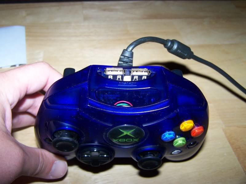

ouside view of modded s-controller
inside view. i removed all the memory card bits and soldered the usb wires straight to the board.
