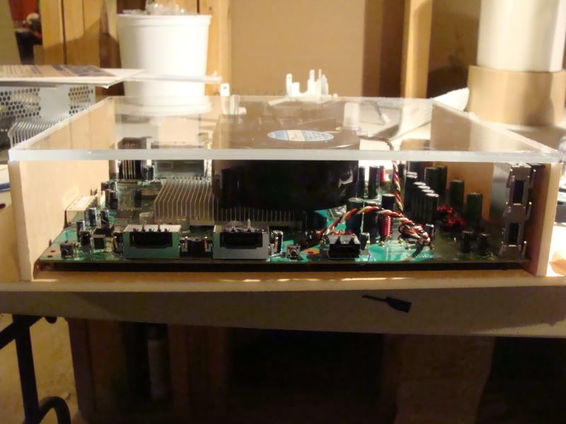

well i see people put plexi glas windows in there xboxs all the time but no one has made one entirely out of plexiglas, thats where i come in smile.gif

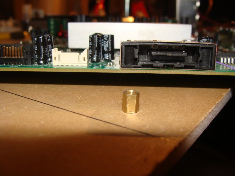

this is how it is mounted to the bottom sheet of plexi

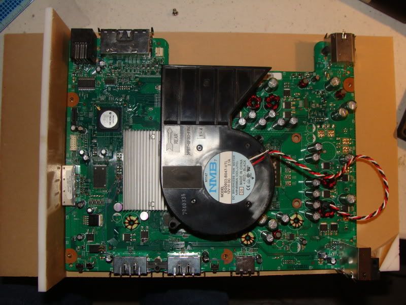

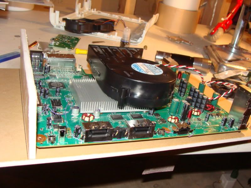

i have a fan concept of a blower fan that sucks hot air of the cpu and gpu and pushes it to the back of 360 and out of the case
Although i dont know what to do for the CPU side because the case isnt very tall and wont fit the normal heatsink, any help/ideas please:

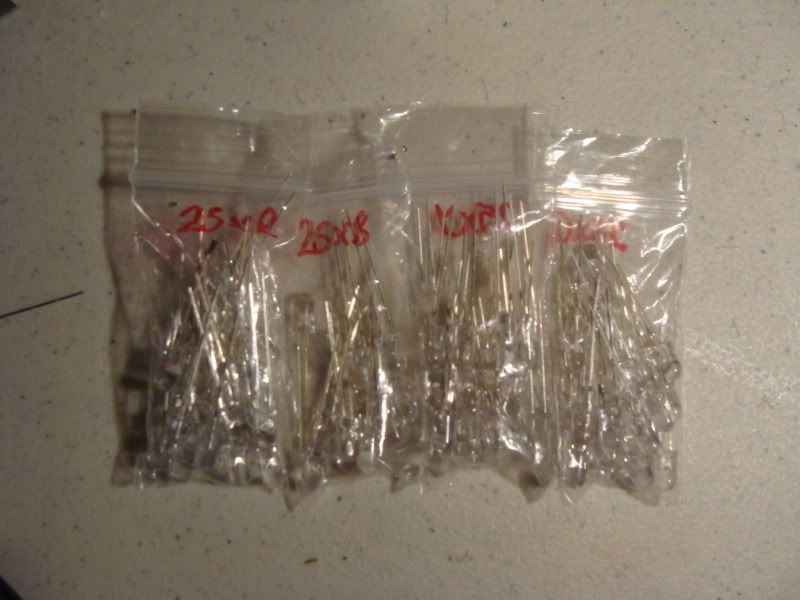

and dont you worry there is no shortage of leds, this thing is gonna glow like the moon cool.gif
and as for the plexi glas types: it will be white plexi (which light still shines through) all the way around and on bottom, and the top peice will be a peice of clear smile.gif
...wish me luck

Use the GPU heatsink for the CPU as well, but you would really want to mod the caps to have them out of the way of airflow.
The next issue is that you would want to seal the top of the heatsink and leave the sides exposed so the the turbine fans get the most air through the heatsink fans.
If you can find a 2nd blower just like that I would mod the exhaust duck and sit them side by side.
One thing that would be needed though is some time of duct on top of the heatsinks to make a good seal but again leave the sides exposed.
One issue with taking the air to the middle of the heatsink is that you won't get a good amount of the heat coming from the core of the heatsink. That means the best method to do with those blowers is if you had a duct that covers the top of the heatsinks and then had the air sucked one of the sides, this way the air passes all the way through the heatsinks and you get the most air put through them.

Hey good luck with this! I recognise those LEDs!
Any problems of help needed let us know.

Thx to all for your tips and pointers, i will have another update tonight for all of yall smile.gif i am really taking the time in this case mod....so it will look good smile.gif and yes phenoptix, those are your leds...SO IM REPRESENTIN smile.gif

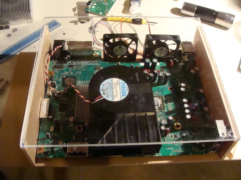

Here you go, i have completed about 70% of the screwing of the plexi together...thats about it lol, and came up with a new way of cooling, idk what you say (no offense) i just wanna try it out: tongue.gif
so basically for the cooling im gonna have a piece of plexi right above the heat sinks, i will put the blower fan right above them to suck the hot air off of them and the cool air will come from the sides under the middle plexi sheet...i have a pic that will better explain smile.gif

Wouldn't it be better to have a fan on top of each heatsink?
#14 killer skittle
killer skittle
  • 245 posts
  • Location:Atlanta, GA
  • Xbox Version:v1.2
Posted 13 May 2010 - 01:38 AM
The blower fan pulls more air than those 2 fans combine! lol

QUOTE(crimsondynamo329 @ May 12 2010, 01:32 PM) View Post
one blower is enough, it should probably be a 120mm rather then the 80mm he has tho.
QUOTE(killer skittle @ May 12 2010, 05:38 PM) View Post
thats not saying much, 50mm fans suck.
QUOTE(killer skittle @ May 10 2010, 07:54 PM) View Post
i hope this is a jtaged box (looks like it is from the 1tb hdd you got there smile.gif ) so you can monitor the actual temps of the procs, you will probably have to run that fan at 12v to keep the console under 140F...assuming its a falcon (its either a falcon or jasper).
looks good, keep us updated.
