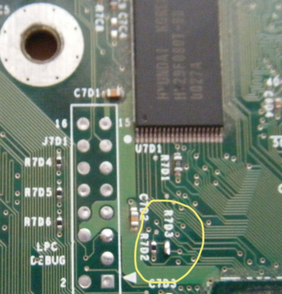

I just finished bridging the solder points to do my first TSOP flash. Just want someone to take a look at my work and tell me if its correct before I botch anything up with the flash.
Here's the pics:
Hopefully I'm all set to flash so I can get rid of the DVD rom in my new slim box smile.gif

xBox booted as it normally would. I'm assuming everything is all good to go.
