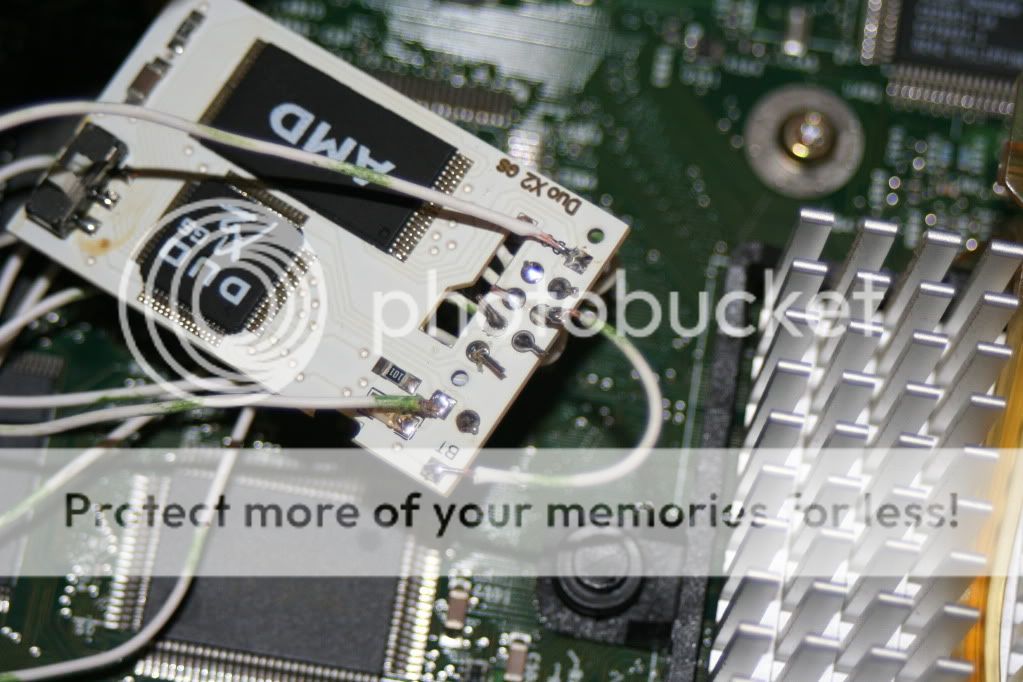

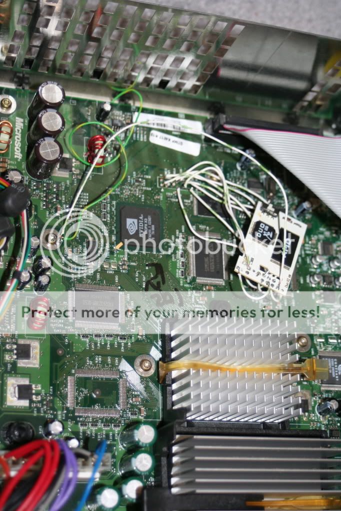

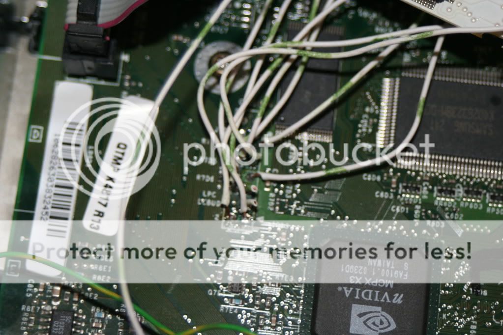

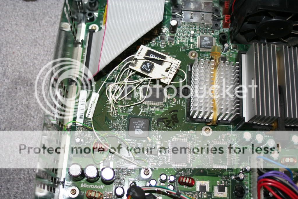

#4 jammin0
jammin0
  • 24 posts
Posted 06 August 2011 - 01:26 AM
Don't know if you're going to be able to see much here but here are some pictures. I originally soldered in 2 extra wires to the LPC that I snipped after I realized I didn't need them. I've gone back over all my joints and looked for any bridges and it looks ok but I will be the first to admit that it seems weird that I needed to ground the chip from on top.
