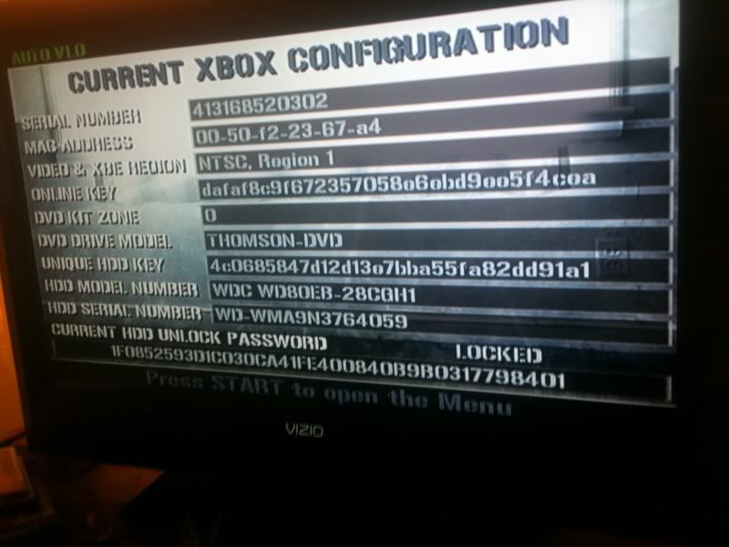

i am having trouble ftping my EEPROM backup from my soft modded xbox to PC. Could i use my memory card and somehow copy the files over to it onto my pc? I also have a screenshot of my Config-Magic info, is there some way i can get a copy of my eeprom from any of these 2 sources?

you can use file explorere to transfer your eeprom from the e: drive on your xbox to your memory unit on your controller.

all you need is the UNIQUE HDD KEY (from configmagic)
and liveinfo (pc app) to make a EEPROM thats useable for HDD locking, unlocking

Using a compatible USB flash drive would be the easiest way assuming a). you have a Xbox compatible flash drive and cool.gif. you have a Xbox controller port to USB (F) adapter or alternative. You'll need tp install Xplorer360 as well to be able to get at files on the drive as they'll be in FATX format.
A standard memory card can do the same thing but you'll need a Xbox controller to PC USB(M) adapter and Xplorer360 for this as well of course.
If you've got an official memory card I'd go for the second method simply because finding a Xbox controller to USB adapter is easier than finding a compatible USB flash drive.
