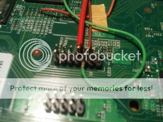

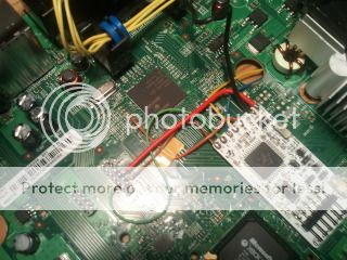

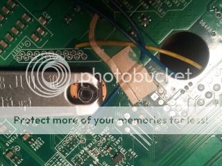

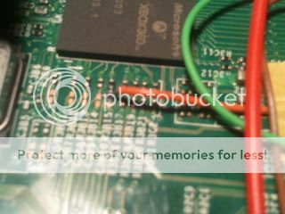

well I have yet to get it to glitch... i double checked all my connections and they are all good....re-programmed the coolrunner... tried the new Jrunner program that is sposed to handle badblocks ... still no go... anyone wanna try making me a ecc file? i have had no luck at all with it....... works fine on original nand dump....
here is some pics of my coolrunner install (not the first one i have done either)

What response are you getting form the coolrunner, eg red light is on? and green light flashes every 4-5 secs?
Are you getting any fan resetting sounds?
What about any other unusual fan sounds?
Have you tested continuity on each wire?
Try another coolrunner board? might be a bad batch!
How did you create your .ecc file? and what program etc.
How did you write the image? by LPT/USB? you used the +w command?
Just give as much detail as possible and we should be able to get this thing glitched.
Most of the time the problem point is the STBY_CLK point, try routing the wire a different way.
You also might have to try some alt points.
One way to test if your box will glitch is to leave the chip as it is now, make sure its on, ground connected and red light on. Flash the stock nand image, and boot the box. It should not boot and should give red light error. If it does boot then the wiring or programming is wrong somewhere.

It looks like your getting the right responses from the chip, It definately has the right timings flashed, eg trinity.jed or trinity1.1.jed ?

well i finally got around to taking another crack at this.... I had since updated to 14719 dash.... I cut 10cm of my blue wire and instead of wrapping under the MB i did a single wrap around the CPU Fan Shroud on top of the MB... I used the latest J-Runner to do all the generating of files and low and behold it glitches in like 4 secs and loads xell and FSD... thanks to the authors of J-Runner!! worked like a charm!!
