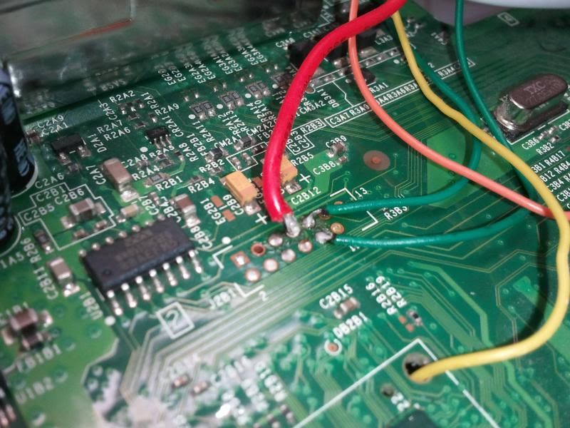

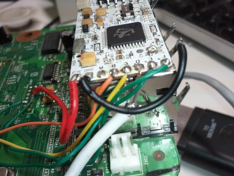

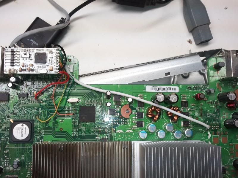

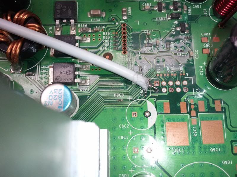

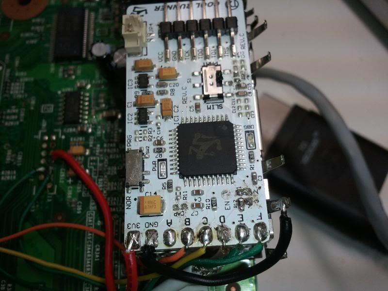

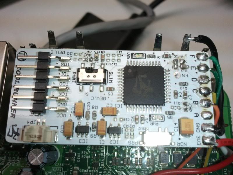

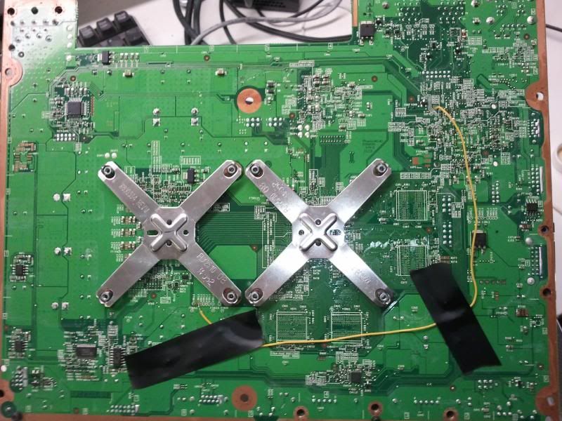

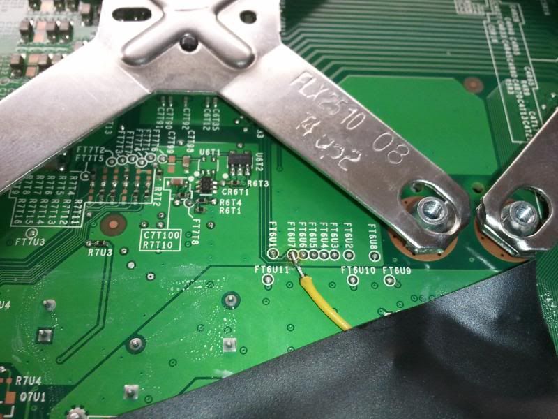

Soldering on the jumper points on the CR look a little sloppy because I've been flashing the coolrunner with different timings and then bridging and unbridging to see if I can get it to glitch. I just didn't take time to clean up the board before snapping the pics.
Two xbox 360's
1. Zephyr
2. Falcon
Pics are of the Falcon.
I started by using the pics in JRunner for "RGH2 on phat w/ wires" (or whatever its called, I'm at work). I set everything up the way that the pics tell me to do for RGH2.
Then after that I used JRunner to read the nands and flash the coolrunner and ecc file to nand. After testing for xell and not being able to get it to glitch I went back and flashed coolrunner to timing A and then testing each jumper config with it. No dice. I then did the same thing with each of the other timings.
I've let each config sit for up to 5 minutes to wait for glitch and xell. Never happened.
I've wired and rewired several times. So much so that I've actually lifted the STBY_CLK point and had to use an alternate on the Zephyr. Ugh.
