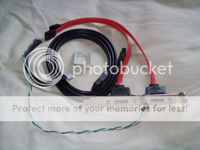

Updates include:
1. I've sanded the external enclosure back with 1200 grit sand paper. Haven't repainted yet but am almost ready to do so.
2. Ordered and Received the internal to external connectors. Including:
Esata Cable - esata to sata 1m (pictured) and 1.8m
Esata bracket - internal sata to external esata connector
internal to external connector dvd power cable
3. Made the case mod for the new consoles connectors look
I've decided where i am finally goig to mount the internal to external connectors on the console. They will be mounted above the network and usb port on the top half of the back of the console. So that it looks neat i have decided to replicate / mirror the case shape around the usb and network port so that the internal to external connectors look good. Here is an illustration of what i want it to look like.
Also I've decided that i'm going to wait till i get a jasper model though so that could be afew weeks to afew months away since i'm in Australia and they still quite rare.
When i get it and start i'll post more updates and pics.
