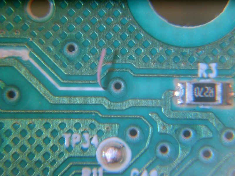

post May 14 2006, 01:24 PM
Posts: 8723
Little more trace repair info for anyone that may need it.

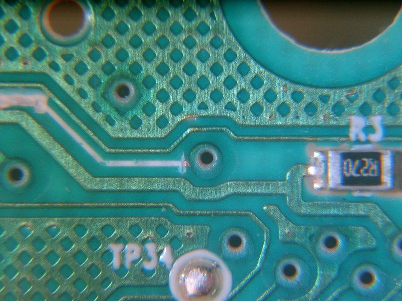

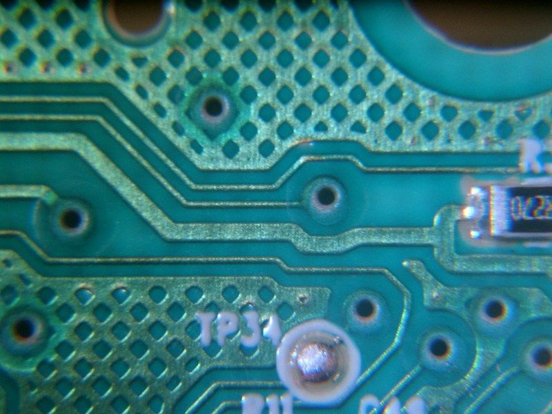

Some of ya may have thought, "Well that was pretty good info, but what if I took something that looked like this...
...and turn it into something that now looks like THIS"
Well, 2 things. First, congrats, you've discovered you probably have no business messing with this kind of stuff, put the soldering iron down and slowly back away. Second, crap happens sometimes and maybe this will get you going again.

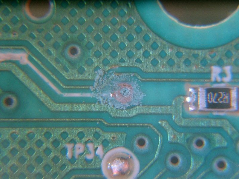

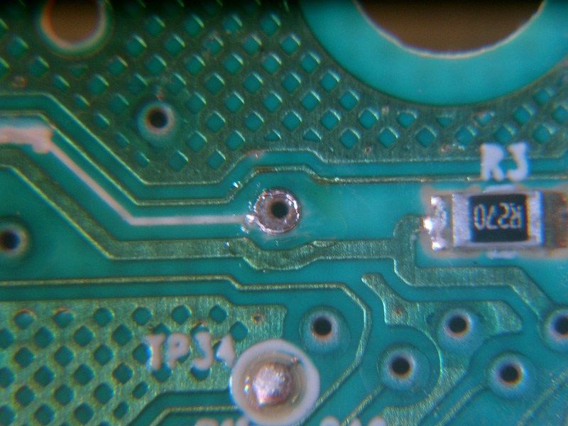

First remove what's left of the trace, there's no point in trying to salvage it and sticking it back on the board with super glue will only get you into trouble later when you go soldering on it. It may have been completely ripped off anyway ad all you're left with is the little bit around the Via* to work with. *(Via = vee-uh, some also call it an eyelet, it's the part in the board that provides the connection form traces on the top of the board to traces on the bottom)

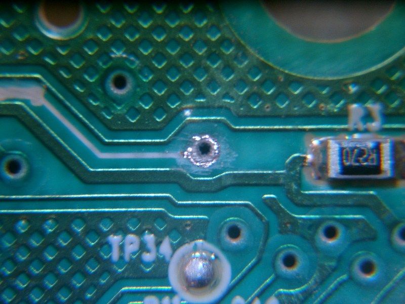

Now we need to remove the Masking off there so the solder can stick. Use a Fiberglass Pen, X-acto knife or small flathead screwdriver to remove it. REMEMBER to make several LIGHT scrapes and remove a little at a time, DON'T go trying to scrape it all off in a few passes, you'll just dig into the board and remove what little there is there to work with already, making a real mess to have to fix up.

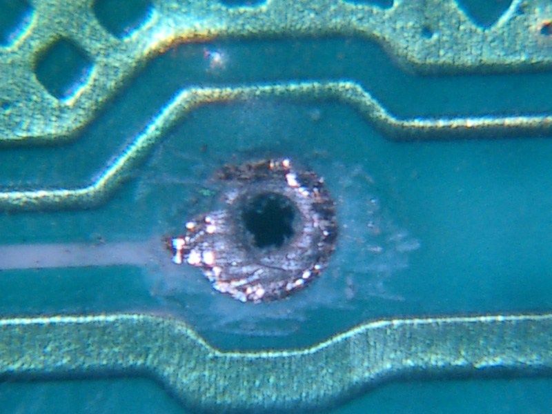

Here we can see most of the Masking removed...
...hold it at different angles or use a flashlight to see if you're down to the copper yet. If it's really shiny you're there...
...and looking even closer we can see a little bit is still there to be removed (top left corner of the Via).

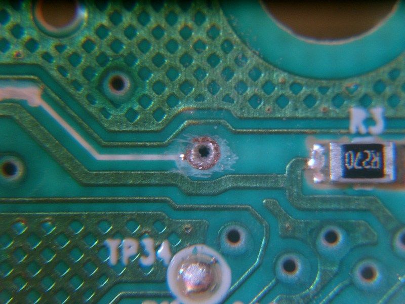

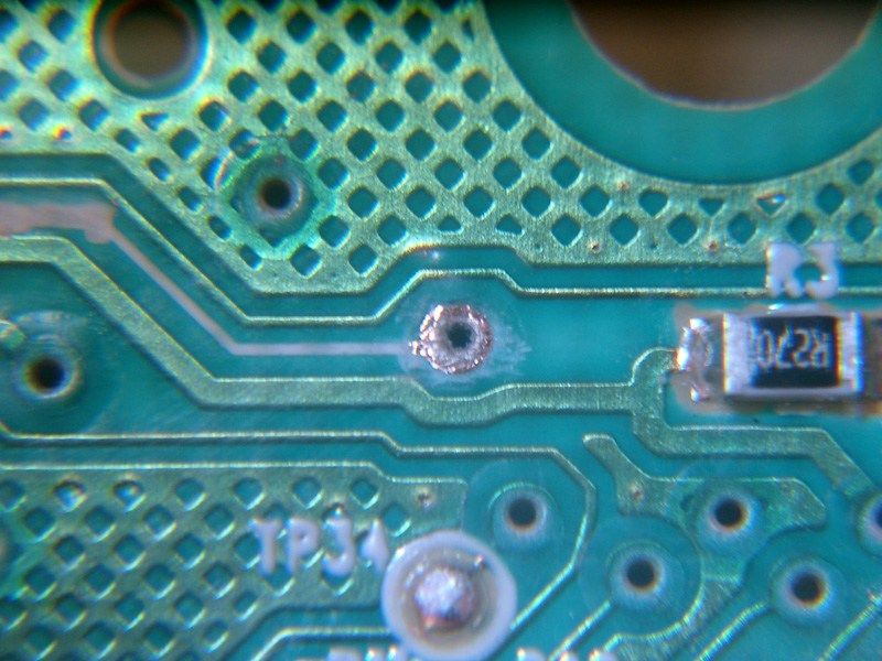

Now we have it all scraped down and ready for some solder.

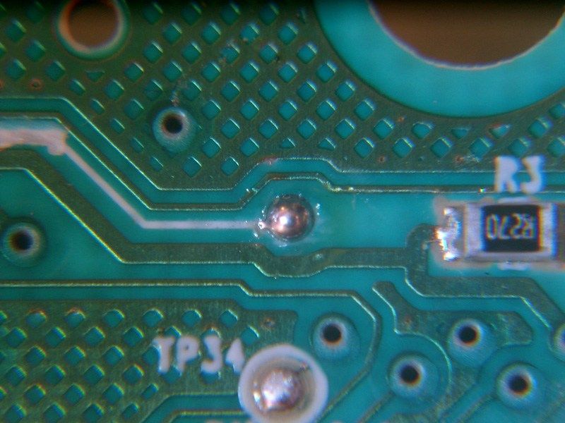

If you have it scraped down to the copper good enough and go to solder on it, this should be the result you get. If not, remove the solder that did stick and go back and scrape a little more.
Now remove the excess solder and you have a nice tinned Via for your wire...

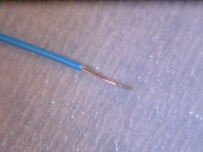

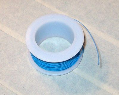

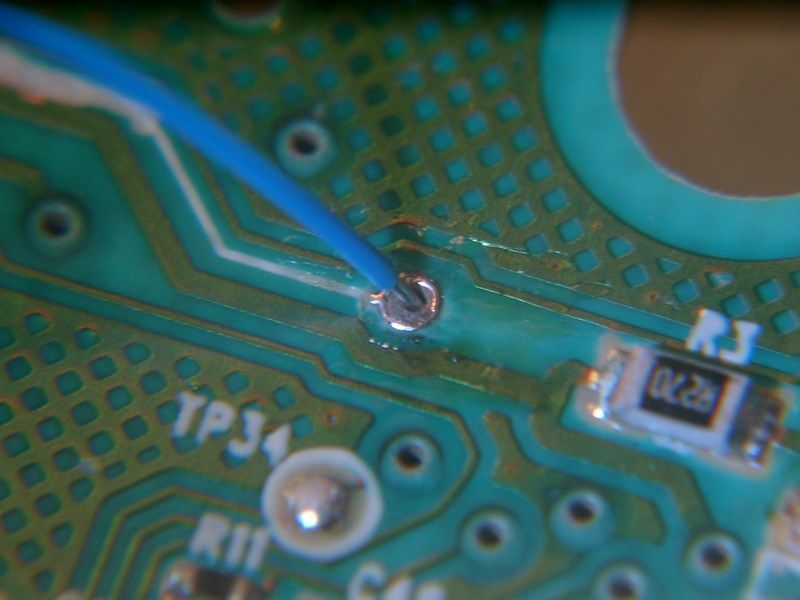

...which should be something really small but easy to work with. This is 30AWG Wrapping Wire (also called Kynar "ki-nar" Wire). You can pick it up at Radio Crack and a ton of online places. Make sure you measure out enough wire to get over the bad spot and from you're new Viato wherever you're soldering the other end to, maybe what's left of the trace on the other end or to another Via and "jumper" over the entire bad spot. Just remember that cutting wire shorter is easy, stretching it really isn't. Also make sure you're not going to be routing the wire anywhere it may get pinched or interfere with something else on the board.
IPB ImageIPB Image
Once you have the wire the length you need, strip off 1/4" or so from the end and tin it with the soldering iron and a little solder. Then trim it down to just a few millimeters.
Place the end of the wire in the Via...

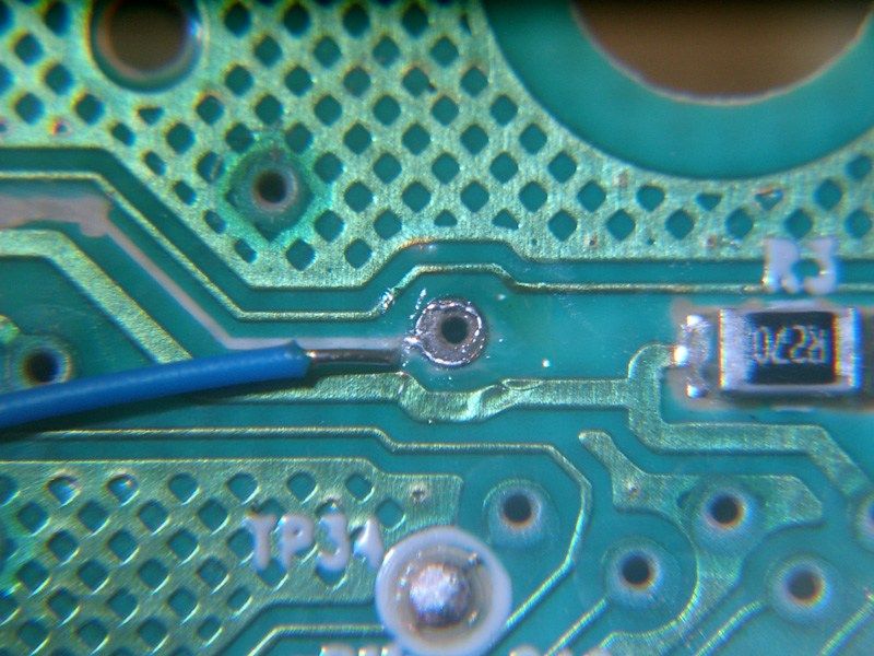

...and solder into place, there ya go. Run the other end to wherever the other half of the original trace was and you should be good to go, be it wat's left of the trace on that end or another Via on that line somewhere.

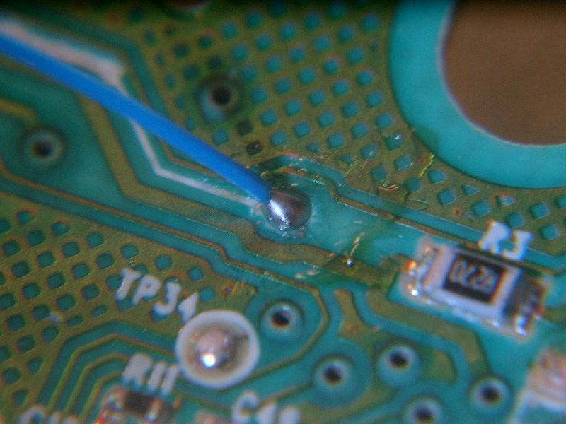

Sometimes the Via is filled with Masking or solder from the factory and the wire will not fit in there at all. DO NOT try to clean it out, you'll end up ruining it and making the repair job way more work than it needs to be. Instead just cover over the Via with solder and then lay the wire flat over it and solder it down to it like so.
