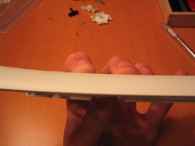

Since my editing option is messed up, I had to change all the original images linked to the paths on the original post.
Ya, it took a long time...
Well, I re-did all of the really blurry pictures that were essential. I apologize for the precut solder joints pictured in the USB removal because the captions are inaccurate.
They say like... "before we start, and ect..." but really, the pictures are higher quality than the original which show the process in the step more clearly.
One picture I wanted to add concerns the removal of the memory card slots. I was trying to describe how you can bend your faceplate so that they easily come out without breaking those securing pieces.
This picture describes how you are going to push your faceplate. Push your thumb up and your middle and pointer finger down.
You'll figure it out when you look at your actual faceplate.
There you go Demon, blurry pictures removed. I'm glad that you requested it because I didn't like the pictures myself. But notice, some pictures have blur... those are not the ones that I consider blurry.
