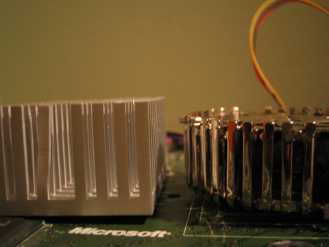

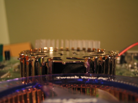

Cooling arrived:

that gpu heatsink is awesome. ive seen the iceberq 4 pro but what is that?? because im making a xbox and i need the heatsinks to be lower so that would be perfect.

yeah me too, im looking for a lower heatsink and that one is koo, how is it in quality? where did you get it? well thanx, and NICE job on that xbox

The GPU heatsink is a Thermaltake Crystal Orb VGA cooling fan, which I found on Newegg.com. It's not quite as short as the Iceberq 4 Pro on the CPU, but at 25mm high it's still shorter than the stock GPU heatsink. Not a whole lot shorter, though; if you're looking for something a lot smaller than the GPU heatsink, you might try something else. The Iceberq is definitely short, though, at 15mm high.
Can't say anything about how they perform yet, but as soon as I get some numbers I'll let you know.

Yeah, the screwholes on the Iceberq line up perfectly.
The fans are actually cheaper at Newegg.com where I got them.
Crystal Orb
Iceberq 4 Pro
