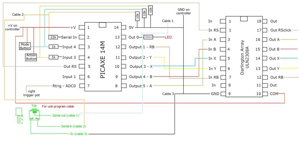

WELL HERE IS AN UPDATE...
My work area:
Now for the good stuff:
http://i306.photobucket.com/albums/nn257/K...LE/DSC01202.jpg
http://i306.photobucket.com/albums/nn257/K...LE/DSC01203.jpg
http://i306.photobucket.com/albums/nn257/K...LE/DSC01204.jpg
http://i306.photobucket.com/albums/nn257/K...LE/DSC01206.jpg
http://i306.photobucket.com/albums/nn257/K...LE/DSC01208.jpg
All i need to do is finish some small soldering and hit glut the chips down and wait for my picaxe which will be here on friday Track it here biggrin.gif biggrin.gif biggrin.gif

Where did u order the Darlington array?? ive been looking around in the internet and no luck ordering the darlington array, all i saw was order like 300 of them minimun....
What kind of cable is that, is that the soft cable 20 gauge or the solid cable?? im making kinda the same as your doing but im puting the d-pad in it too with a picaxe 28 pins its a time consuming project but im almost complete...
...exept for the freaking female 3.5mm stereo phone jack that they sell in picaxe that doesnt have the pins numbered, and im having a hard time figuring out which pin (in the female connector) is which (they have a above view of it but i cant really make a picture of it. (sorry but when the picture says above i hold the connector with the pins upwards and i look down, with the jack facing away, and i map as it is) so i did it that way but the picaxe wasnt detected by the computer. if you could take a picture of that jack and tell me how you route your pins that would be helpful.

QUOTE(assbinator @ Mar 10 2009, 03:00 PM) *
i see if i can post my project with the dpads...
nice going!!!
One word...SPARKFUN.com!!! best site for this stuff! This is the download cable i used for the picaxe
Heres the schematic i used for the download cable connector
This is the audio jack i used!
p.s. picture are always welcome her so post ur progress!

Sorry for the bump, but why is a darlington used?
