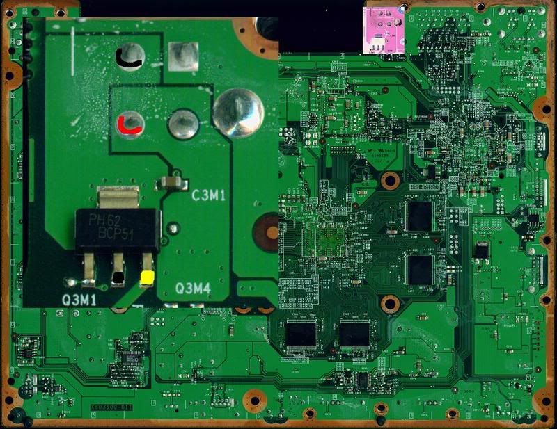

i know a lot of you are still cutting the + wire on the fans and just wiring it to a 12v spot on the board, altho this dose work there is an easier way that doesn't require modifying the fans.
for a lesser fan speed cut the ground of both fans and run both ground wires to a power source (after doing the 12v fan mod).
for 7v ground to this point: Xenon, Zephyr/Falcon/Opus/Jasper
for 9v ground to this point: Xenon, Zeyphr/Falcon/Opus/Jasper
Xenon:
Bottom of the Board:
Yellow=12v Black=CPU Red=GPU
(If your Having Trouble Understanding Click the Picture)
OR
Top of the Board:
Bridge Black for CPU, Bridge Red For GPU.

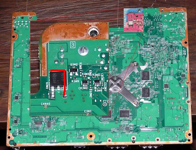

Zephyr, Falcon, Opus & Jasper:
The Zephyr, Falcon, Opus and Jasper Board have the same voltage line to both fans
so it wont be possible to 12 or 7v just one fan w/o cutting the wires.
OR
Top of the Board:
Note: Sunon and Nidec Fans have Reversed Power Wires.

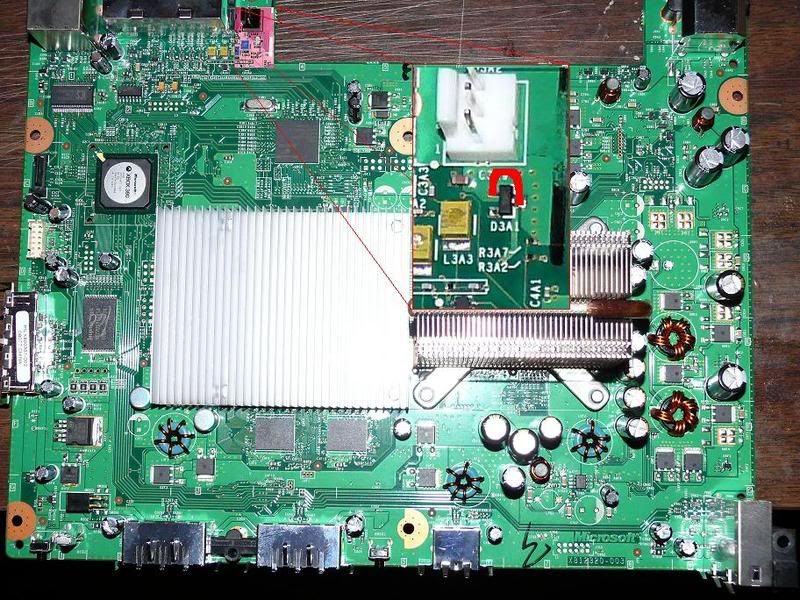

Trinity/Valhalla:
Red=5v, Yellow=Fan Speed Control.
Bridge for Full Speed.
Potentiometer for Controlled speed.
If you plan to use a potentiometer to manually adjust the fan speed here is one
that is close to the right strength and here is how it should be used.

this is a very easy and safe way to do a 12V mod.
Basically, that transistor connects the fan line to 12V on and off many times a second, creating a voltage on the fan somewhere between 0 and 12v.
Shorting the transistor essentially turns it on 100% of the time, so the fans will be at 12V. It does no damage to the transistor, simply bypasses it.
This will also make your fans work if the transistor is blown (fans don't spin).
Another idea: if you put a potentiometer across the pins of the transistor, then you would be able to control how much you are "boosting" the fan speed. Potentiometer at highest resistance = stock fan speed, as it drops to zero the fans will speed up more and more, until resistance = 0 and the fans are at 12V.

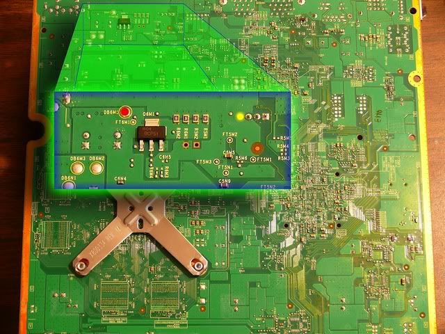

which brings me to the v3 board, i finally got around to modifying the cooling system on a falcon i got in a couple months ago and it turns out if you wire the fans ground to 5v it will throw 0001, also the board is designed differently so the points to solder for 12v are different, if i have time i will take it back apart and take pictures, if not i will get some posted of the next one i get.

don't use t-taps, if you really want to do it right now there's a big mosfet right around the same spot on the underside, just wire one of the legs to the head.

Added: v3 Falcon, Simple 7v.
