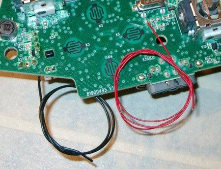

yes those extra pins are good sources of a switching supply, but since they don't really provide enough voltage to light the leds correctly I made a small circuit to give the full battery voltage to the leds when the controller is on, and 0v when it is off.
You just need a NPN transistor ( I used a 2n3904), a 1K resistor (2K works too).
The pins of the transistor are labeled Emitter, Base, and Collector, and are similarly labled "E" "B" and "C" in my crappy drawing to show you how to hook it up.
This post has been edited by G0t M4xx 21: May 26 2006, 05:19 PM
post May 26 2006, 07:07 PM
Post #20
Posts: 8705
There's a nice spot over in the corner of the controler to mount the thing too, complete with a 2v spot that turns on/off with the controller to turn the transistor on/off to turn the L.E.Ds on/off.
Just make sure like G0t M4xx 21 said you use an NPN transistor and get the Emitter, Base, Collector connected right. In these pics I used an NTE289A, but any small NPN in a TO-92 or Giant TO-92 package will work just fine.
TOP SIDE OF BOARD
BOTTOM SIDE OF BOARD
TRANSISTOR AND RESISTOR INSTALLED (NOTE: Make SURE you install your transistor correctly, it may not have the same Emitter Base Collector configuration as this one)
SWITCHED SOURCE The Black wire is connected to the Collector of the transistor. The Red wire is connected to your + voltage source.
The AA spot will put out 3v, the Rechargeable and AA spot will put out 2.5v-2.7v
This post has been edited by RDC: May 26 2006, 07:24 PM

post May 29 2006, 05:41 AM
Post #24
Posts: 8705
Nope, all of the voltage points used in this thread thus far stay on in the Wired controller, even when the 360 is off. 3.3v between pins 1 and 4, then the 2v switched I use on the Wireless stays at 2.5v on the Wired. The board I have is pretty chewed up, but I'll look around for a switched voltage in there and see if there is anything to work with.
Found it already, just use any spot on the Sticks or Triggers voltage line. It sits at 1.6v on and then 0v when the 360 is off. That's enough to turn the transistor on and off, provided you do it that way.

post May 29 2006, 10:34 PM
Post #26
Posts: 8705
Here ya go.
