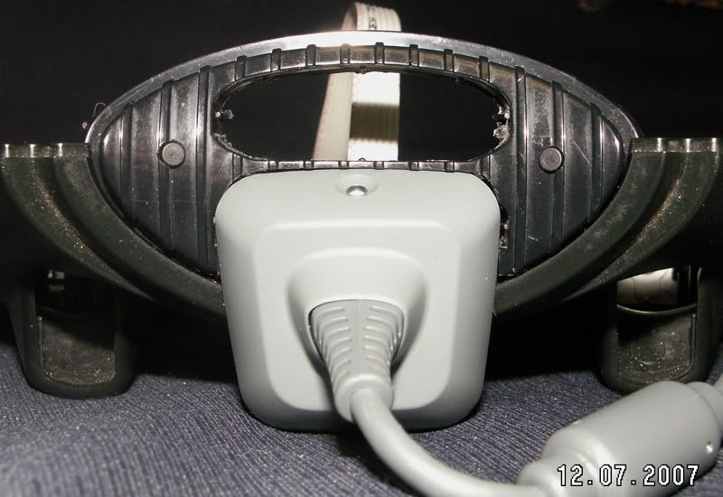

Here's the PnC attached (yes it's removable, same as any 360 wireless controller) just showing it in place since the gaping hole behind there and how the PnC connector are mounted right now isn't much to look at at the moment. I figure the Sync button can go here as well, it's a good a place as any and out of the way for any accidental pressing of it in game. The other button will most likely be for Guide right now, still not sure how I want to go about that part of it, so up there out of the way is fine for it right now, plus tearing up the dome isn't something I feel like getting into right now. Next one I do I'll try something else on for the LEDs and Guide/Dome, I consider this one a prototype for the most part anyway, just getting all the crap ironed out even though it's fully functional in the state it is now. Only thing really missing is the Headset jack, and honestly I'm not that keen on installing it anyway.

Here's a shot of it connected up and charging a PnC battery pack. Playing Halo on the 360 with this thing is a rush of nostalgia and a little weird to boot, since it both is and isn't quite right, and going back to a Wireless 360 controller after messing with this thing awhile is wild. I may lay into it later on with the Bondo, Glazing Putty and Plastic Welder, but right now it's pretty much done and works, that's just gonna get it to a point where I'll have to paint something and since that's not my strong suit I'm content to leave it like it is for now.
