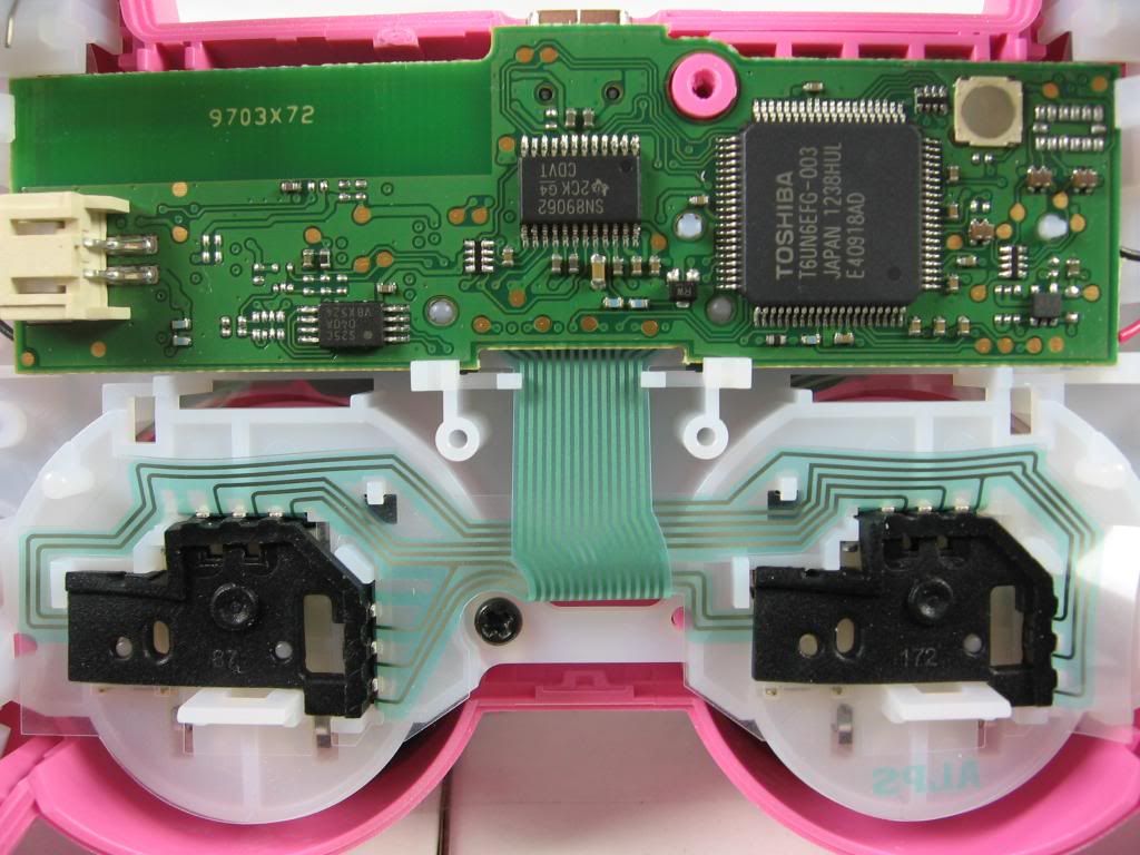

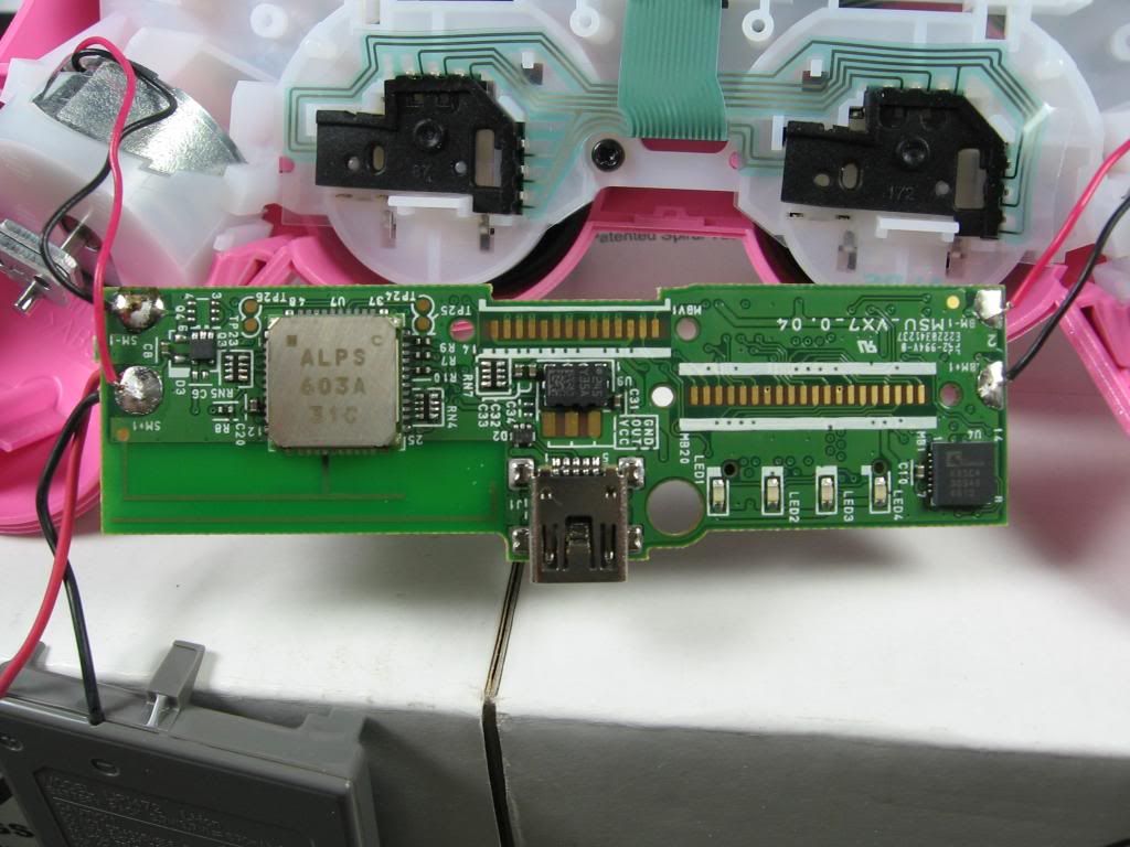

Greetings folks,
Opened up some brand new pink PS3 Sony wireless dual shock controllers to find yet another new circuit board. This one is the VX7.
Attached are some raw pics. I apologize for not having the time to do hi-res board scans. I also apologize but I do not have time to do a write-up detailing the differences on the new VX7 board compared to previous boards. In short summary, the battery and the MCU are identical to the previous VX6 board. If you have a favorite modchip that worked with VX6, it will work on VX7 as well with no software modifications required.
Overall view:
Frontside:
Backside:

The below photo shows you the COM1 and COM2 points (as well as the other points I use on my modchip, as well as one possible wire placement recommendation)
Brought to you by the guys at Viking Controllers :-)
