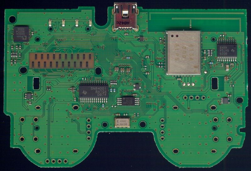

Here are some of the newer versions boards. The main differences in these newer controllers are the Battery and the Analog Sticks, the boards are completely revamped as well, but you'll notice the Battery and/or POT leads right off, plus the shell of the controller doesn't seem to be the transparent 'smoke' color anymore but a more opaque Black color.
The first version of battery was the LIP1359 (w/sticker) then came the MK11-2902. While the newer MK11 is smaller in size, it's still the same 3.7v 610mAh rating. It also uses a bracket to fit where the slightly larger LIP1359 went. These batteries can be interchanged between the 6A (Six-Axis) and DS3 (DualShock 3) controller versions if need be and I've seen both battery versions in the later versions as well. There is also an MK11-3020 570mAh (Typ610mAh) that turned up later on, and seems to be the same as the other MK11, and now the LIP1359 (w/o sticker) seems to be the more frequently used one in the latest controllers, but again they are all interchangeable and one is really no different than the other, you just need to have the bracket for the MK11 batteries so they fit properly is all, but even that's really optional in a pinch.
The big surprise is the Analog Sticks in these newer versions, 4 legs on the POTs, needless to say that sparked some interest. So I desoldered one, popped it off and looky here...
..gone are the days of the familiar 3 legged POT and in comes these little gems. Magnetic and nothing to get all dirty and scratchy since there's no Wiper anymore, pretty nice idea, though a bit high tech for something that has no user serviceable battery and will in most cases be replaced instead of repaired if it were to die or break, still really kool though. These are Hall Sensors, and there are now 2 versions of these in the DualShock 3 version controllers, though the older style ones aren't used anymore as they seem too have a flaw with them, in that the Rivets that hold the leads onto the small circuit board can cause an intermittent connection over time and this will cause a direction or two to stop working, the newer ones are designed a bit better and I don't see them having this issue. How these things work is they have a Current run thru them and depending on where the Magnet is at (the part on the stick) it changes the flow of the Current in this Sensor. This then goes to an Op-Amp setup as a Current-to-Voltage converter and when all is said and done they basically work exactly the same way as a POT setup as a voltage divider, the MCU in the controller doesn't know the difference. This was done years back in the Saturn 3D controller as well as the Dreamcast controllers.

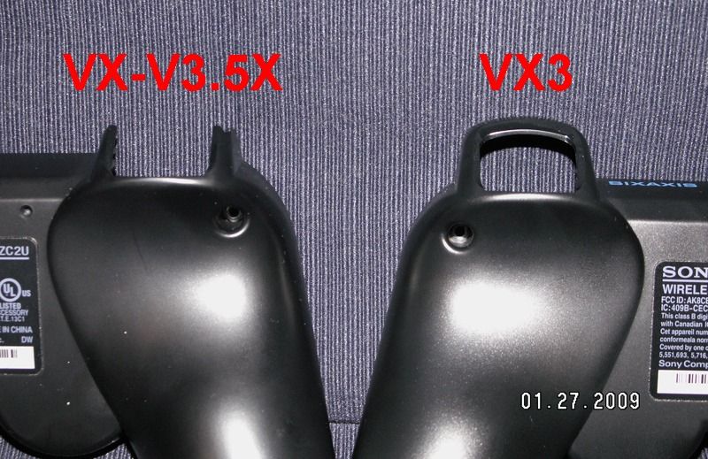

Well here we go with the latest version of the DS3 and all of it's revised goodness. The board version number is below, but you can tell if ya have this one before even opening the controller as they have redone the bottom half of the shell and made it all once piece instead of having the small filler pieces between L1/R1 and L2/R2 like every version before it.
This doesn't necessarily mean if it has that bottom half it's this exact version, newer versions may also use this redesigned shell, but it's a pretty quick way to tell ya don't have one of the older DS3 versions without having to open the controller up.
Inside the controller they've done away with the metal brackets that hold the Rumble motors and made the Daughter board brace hold them, PS2 controller style. The Daughter board still uses the same type of pressure fit connection as the V3.5X has, as well as the same Daughter board.

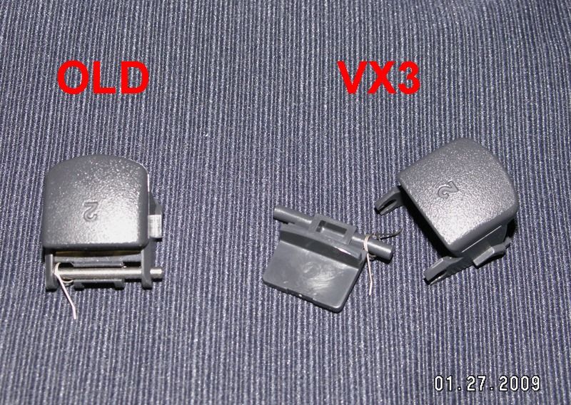

The Triggers pivot pin has now been made from plastic instead of having a metal pin, this was most likely done to reduce costs, and it makes the older L2/R2 incompatible with the newer design, so if ya ever need to replace them for any reason on this version of controller they'll have to be this newer style.

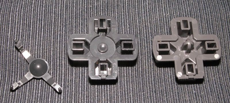

And yet another revision change, this time around has some more changes as well, similar to when they went to the VX3 versions above, but this is the VX4.
The Daughter board has been updated slightly, though it works the same way as before. The Daughter board brace is slightly revised also and holds the Rumble motors a bit differently, as well as clips into the controller shell now.
One of the slight changes is the D-pad, instead of the older 2 piece design shown on the left, it's now just the once piece shown on the right.
