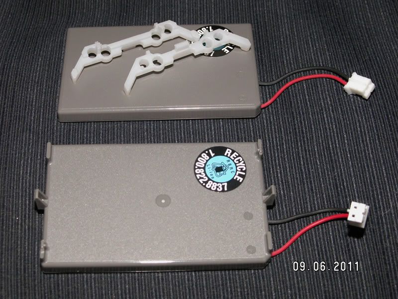

The first version of battery was the LIP1359 (w/sticker) then came the MK11-2902. While the newer MK11 is smaller in size, it's still the same 3.7v 610mAh rating. It also uses a bracket to fit where the slightly larger LIP1359 went. These batteries can be interchanged between the 6A (Six-Axis) and DS3 (DualShock 3) controller versions if need be and I've seen both battery versions in the later versions as well. There is also an MK11-3020 570mAh (Typ610mAh) that turned up later on, and seems to be the same as the other MK11, and now the LIP1359 (w/o sticker) seems to be the more frequently used one in the latest controllers, but again they are all interchangeable and one is really no different than the other, you just need to have the bracket for the MK11 batteries so they fit properly is all, but even that's really optional in a pinch.

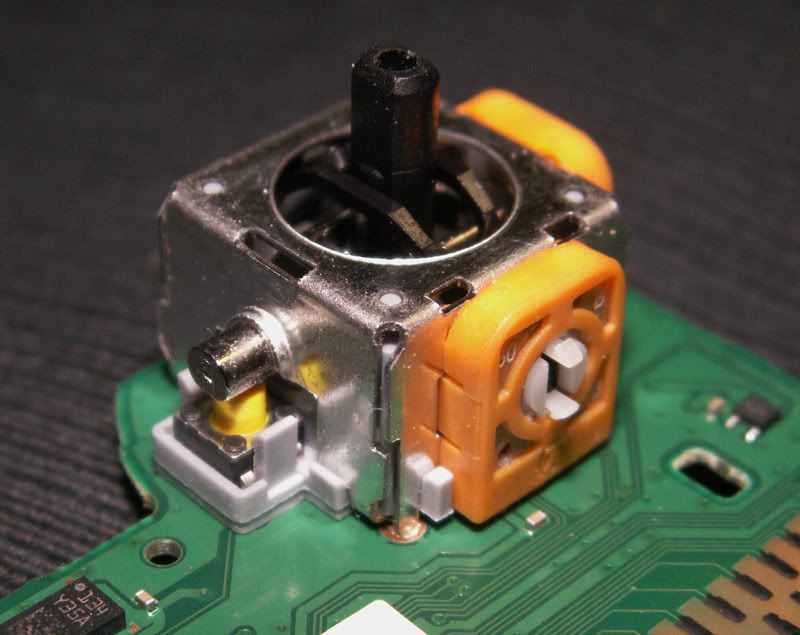

The big surprise is the Analog Sticks in these newer versions, 4 legs on the POTs, needless to say that sparked some interest. So I desoldered one, popped it off and looky here...
..gone are the days of the familiar 3 legged POT and in comes these little gems. Magnetic and nothing to get all dirty and scratchy since there's no Wiper anymore, pretty nice idea, though a bit high tech for something that has no user serviceable battery and will in most cases be replaced instead of repaired if it were to die or break, still really kool though. These are Hall Sensors, and there are now 2 versions of these in the DualShock 3 version controllers, though the older style ones aren't used anymore as they seem too have a flaw with them, in that the Rivets that hold the leads onto the small circuit board can cause an intermittent connection over time and this will cause a direction or two to stop working, the newer ones are designed a bit better and I don't see them having this issue. How these things work is they have a Current run thru them and depending on where the Magnet is at (the part on the stick) it changes the flow of the Current in this Sensor. This then goes to an Op-Amp setup as a Current-to-Voltage converter and when all is said and done they basically work exactly the same way as a POT setup as a voltage divider, the MCU in the controller doesn't know the difference. This was done years back in the Saturn 3D controller as well as the Dreamcast controllers.

The Battery has been changed to do away with the plastic spacers needed. It's now an LIP1472, but everything else is the same as the LIP1359 (see above posts) and it can be swapped for any of the other battery versions or vice-versa with the correct spacers.

The 4 leg Hall Sensor style Sticks are gone, back are the old 10k POT style, but still not the 'typical' size, so replacing them is again a hassle.
