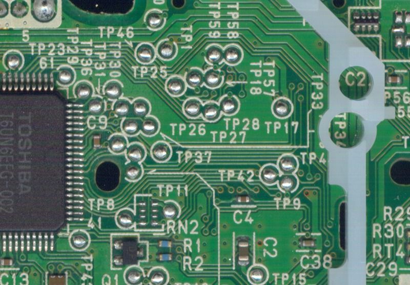

Here are the list of TP spots on the PS3 controllers, the most useful ones anyway, for anyone that would want to make up an Arcade Stick, add an extra button or something similar.
Of the 17 versions of these controllers, that I know of, there are (so far anyway) 7 different TP layouts for them. These are a general pic of the different layouts, what controller version they're on and what they do.
NOTE: All of the TP spots are NOT shown in these pics, this is just for reference so you can tell which controller you have at a glance and what TP spots are what on that version of controller.
These are for the USB Connector and they are the same on all versions of board, except the Asuka.
TP1 - 5v
TP2 - D-
TP3 - D+
TP4 - Ground
GND - Ground
This is for the older Six-Axis controllers.
Any of the MSUPP 4.0 versions that have the 3 legged POTs. The TP spots may or may not be tinned with solder also.
TP10 - V (Common Line for Home button)
TP17 - COM 1 (Common Line for D-pad and L1/2)
TP18 - COM 2 (Common Line for X, /\, [ ], O and R1/2)
TP26 - PS (Home Button)
TP27 - Start
TP28 - R3 (Stick button)
TP29 - L3 (Stick button)
TP30 - Select
TP31 - X
TP32 - R1
TP33 - R2
TP34 - L1
TP35 - DL (D-pad Left)
TP37 - [ ]
TP38 - O
TP39 - /\
TP41 - L2
TP42 - DD (D-pad Down)
TP43 - DR (D-pad Right)
TP44 - DU (D-pad Up)
TP60 - COM 3 (Common Line for Select, Start, L3 and R3)

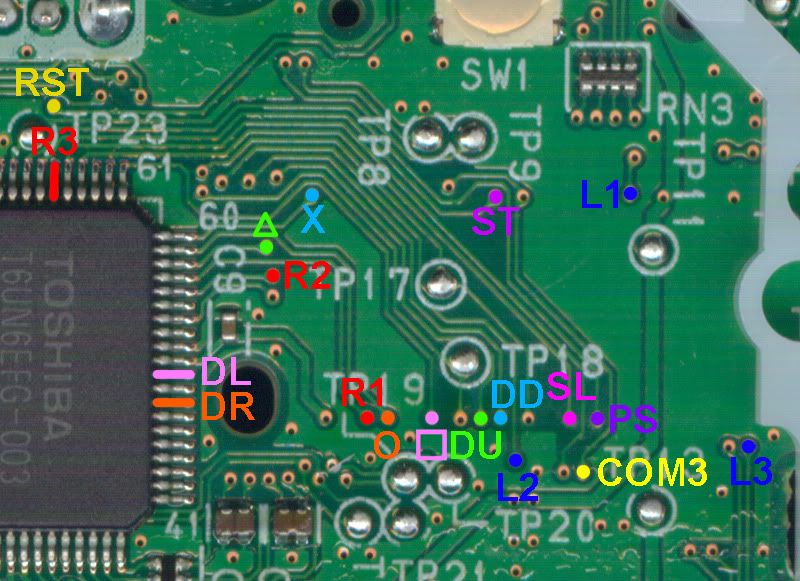

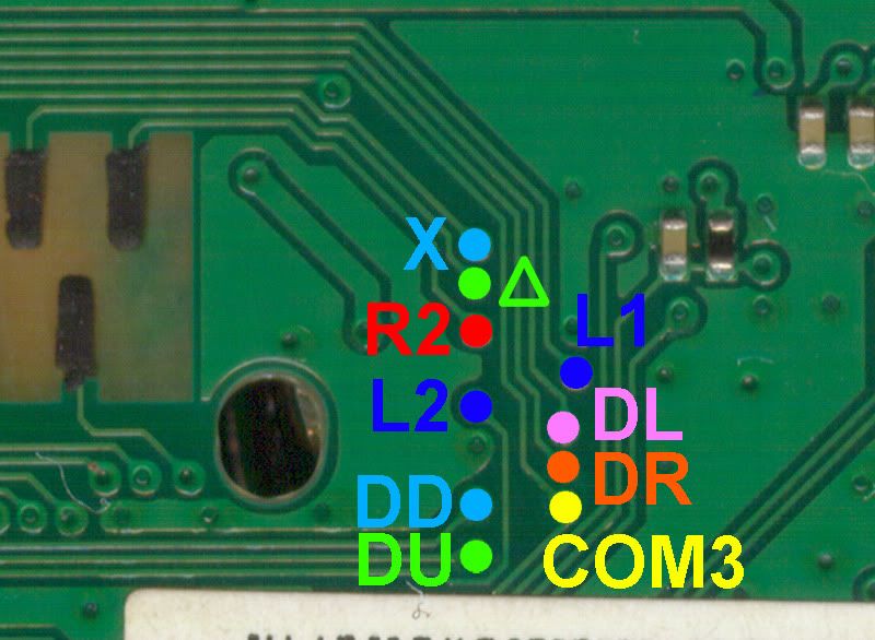

There is no TP spot for the COM 3 line on this version of board, best place to use is one of the solder joints of the L3/R3 buttons.
On the latest version of DS3 controllers there isn't much in the way of useful TP spots, but here they are.
MSU_VX3
The TP spots for the buttons have all been removed from this board version, so that means hitting a Via to attach wires, and they're about 1/3 the size of the ones in a 360 controller, so even if you're pretty good at landing a wire on those you'll have to be a a lot more careful scraping down and landing one on these things.
Right now this is probably the best spots to hit for an Arcade Stick or duplicate buttons, and until I use this board for something they should suffice, so this part here may be updated after I've done some more work on the board wiring it up to something and seeing which methods and spots work best. They were nice enough to leave the COM1 and COM2 TP spots behind, though that hardly makes it any easier if you were making an Arcade Stick from this version of board and it'll make building a PS360 with this version of board a little more fun as well. wink.gif
There isn't much in the way of useful TP spots, but here they are, and like all of the other versions of controller the USB TP spots are still the same.
TP11 - LED + and V (Common Line for Home Button)
TP13 - 2.8v (Switched, Power for Sticks)
TP14 - Battery +
TP17 - COM1
TP18 - COM2
RST is the Reset or 'off' button on the bottom of the controller that pretty much no one uses I'd imagine. The other side of it is Ground and any spot will work if you want to duplicate that button for any reason.
Again there is no TP spot for the COM3 line and the best place to use is one of the solder joints for the L3/R3 buttons, or you can hit a Via for it if you like.
For any Arcade Stick builders using this board version, soldering to the Vias on these controllers isn't exactly the easiest thing to do, flipping the board over and using the contacts for the Daughter board is really the best option.
The black carbon material needs to be removed if these spots are to be used, and this can be done with an X-acto knife or some fine sandpaper, just be careful and when you get to the shiny copper, STOP, you're done. Tin it up with some solder and there are your spots to use. Try and use a 30awg wire, or 28awg at the largest, and make sure to secure the wiring with some hot glue after you make the connection, but don't glue over the solder joint you just made, secure the wire to the board back from the solder joint, in case you ever have to get to it again for any reason.
The Pull-Up Resistors (7.5k) also need to be put back in the circuit as they're built into the Daughter board and when it's removed they're not, and the controller will act up on you if these are not in circuit, why Sony decided to do this back with the PS2 controllers and carry it over to the PS3 is beyond me, it's really lame. There needs to be 2 of these Pull-Up Resistors installed, one goes from V to COM1, the other goes from V to COM2. If you don't have any 7.5k Resistors you can use anything from 6.8k to 10k really, but they do need to be installed since the Daughter board is removed, and all of the PS3 controllers are setup this way and need those Pull-Ups if the Daughter board is removed.

On the V2.5 board you'd have a Resistor installed between TP62 and TP25, then another one from TP62 to TP26.
We kind of thought about it having resistance at first, but we must not have tested it in the wrong spots because we could never find any. And we tried using a couple resistors, but not set up the way you suggested, and no where near the amount you've stated.
In any case, we've got the controller setup the way you suggested in a breadboard and it's working perfectly w/o the daughter board! Thank you!
QUOTE(RDC @ Feb 3 2009, 06:50 PM) *
Also, if you're trying to do something like use the PS3 controller as your 'base' controller and wire up some other controller, as to use it's buttons instead, take caution in to how the other controller is laid out. The PS3 controllers have a 3 Common Line setup and most other controllers you'll run across are Common Ground or Common Line. Wiring up the PS3 controller to a different button layout on anther controller will cause issues there as you'll be connecting lines on the PS3 controller thru the other controller that shouldn't be.
We are actually essentially just wiring it up to "transfer" the button presses from one PS3 controller to another PS3 controller. We weren't able to get both controllers to take the inputs from the buttons consistently in our last test yesterday however. Hopefully today with this new setup we can get them to register button presses exactly the same on a consistent basis. I will keep you posted! And again, thanks a bunch! smile.gif
This post has been edited by RDC: Feb 19 2009, 02:47 AM

Technically all of the buttons on the PS3 controllers have Resistance, they're all Analog (Pressure Sensitive) so they have to be setup that way, but it's the Pull Up Resistors that are built into the Daughter board that are needed for it to at the very least function.

Wow amazing work! I'm impressed! Btw, how would you go about finding what each point does? Poking with a multimeter?
post Feb 18 2009, 07:12 AM
Posts: 8705
QUOTE(bustinthejus @ Feb 18 2009, 12:27 AM) *
Thanks. Your eyes are about the only thing ya really need, and a decent magnifying glass doesn't hurt at all, though to do it properly you'll need a multimeter to make sure it's the same spot from one end to the other and that ya didn't get lost along the way. wink.gif
