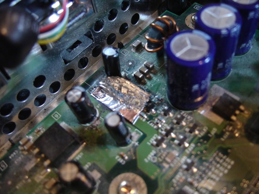

Here is a picture taken by another member of this forum with almost an identical problem. My capcitor is the aerogel one that is closest to the C6V2 (on the left).
On mine there is not visible damage under the motherboard, but I think that the capacitor that blew took out a bridge or something with it. I removed the capacitor, but the xbox is still giving the reboot twice problem described in my first post. There is still no picture and the only clue I have is the alternating lights.

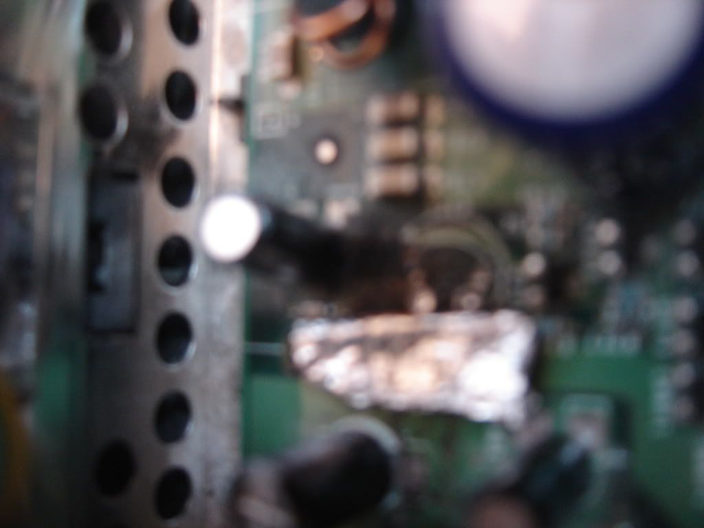

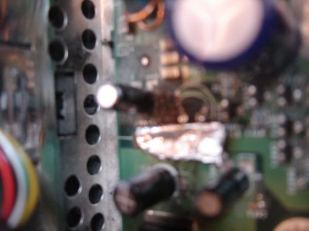

Turns out something got toasted by the goo inside the capacitor, this was causing the restarting twice problem. I linked the two ends with a piece of aluminum foil and folded it down. The tin foil worked. Here is a pic:

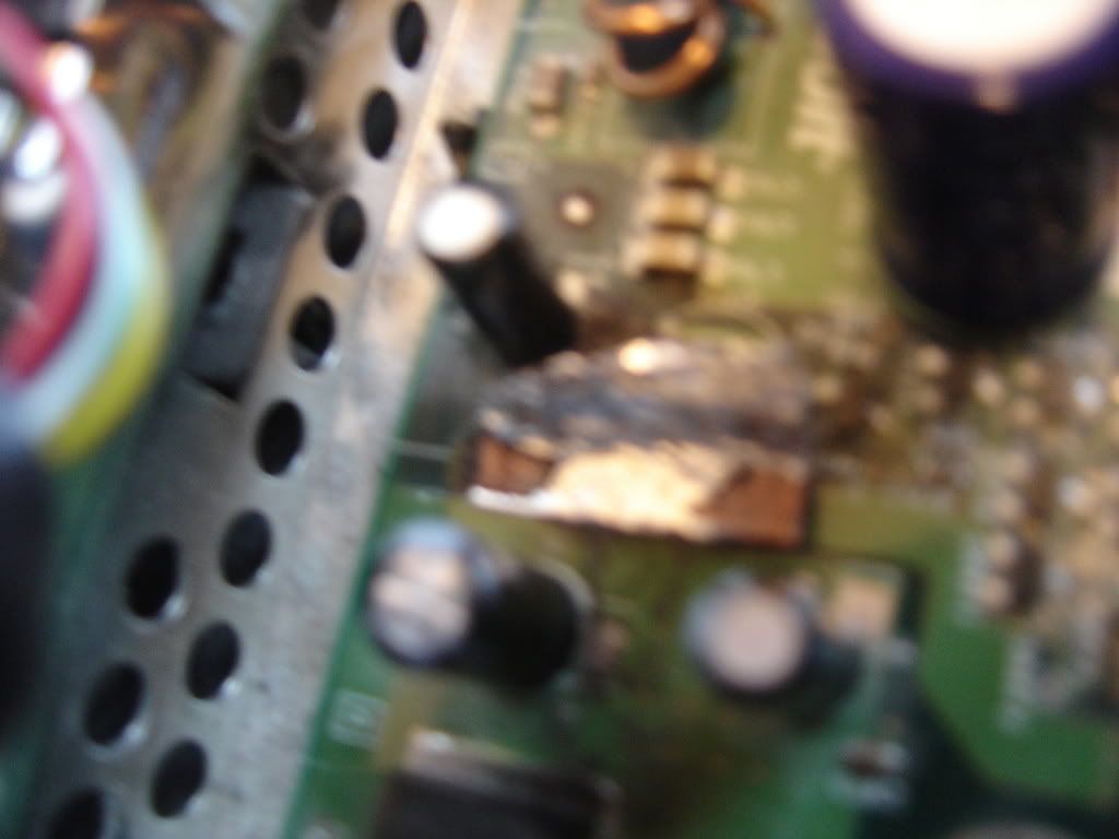

In regards to the capacitor, it has been removed, however it left the goo all over the motherboard and I have heard that this can be corrosive. Here are some pics:
Currently the xbox is working fine since linking the two ends with the tin foil. I only have two questions:
1. Is using aluminum foil a fire hazard, or a hazard to any other components?
2. Does the capacitor need to be replaced to maintain normal working operation of the xbox?

1. As long as the foil doesn't touch anything else, you should be fine. I would recommend to replace it by a piece of isolated wire. It will probably have a lower resistance than the foil.
2. You don't need that capacitor. You will only notice that you will need to set the clock when you disconnect the power plug every time.
3. You might remove the stuff that came out of the capacitor. Try something like desinfection alcohol. Or use a contact cleaner spray to remove it. You can dry the pcb afterwards with an air compressor.
regards.
