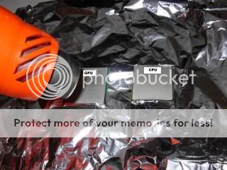

I made a tutorial on one way to fix the Red flashing light of death, by using reflow treatment with a heat gun,

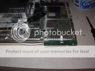

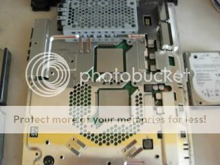

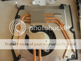

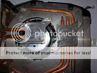

Remove hard drive, open the console, remove Blu-ray drive, power source and another parts,

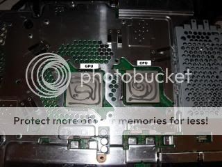

Remove main heat sink screw's, remove fan, clean off old thermal paste with rubbing alcohol and clean cloth.
Have the ps3 motherboard with no protected cover over it anymore.

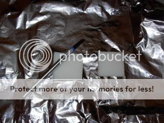

Copy CPU/GPU shape's with the tinfoil and cut out with exacto knife, don't cut shape's over ps3 motherboard.
Set heat gun to high, have gun nozzle about half inch away from the face of chip, heat up each chip for about 15 to 25 sec, don't over due that, repeat heat process on each chip about 6 time's, when you can't even put your finger on the chip's for less then a sec, your on the right heat process.
after when you do each chip for 15 to 25 sec go to the other side of motherboard real quick and heat both back side of chip's for 15 sec, then let cool down for 5 min and repeat 6 time's as well.
Once you done the whole process, put protected cover on and reply new thermal paste to both chip's.
also a little on your heat sink, not to much.
