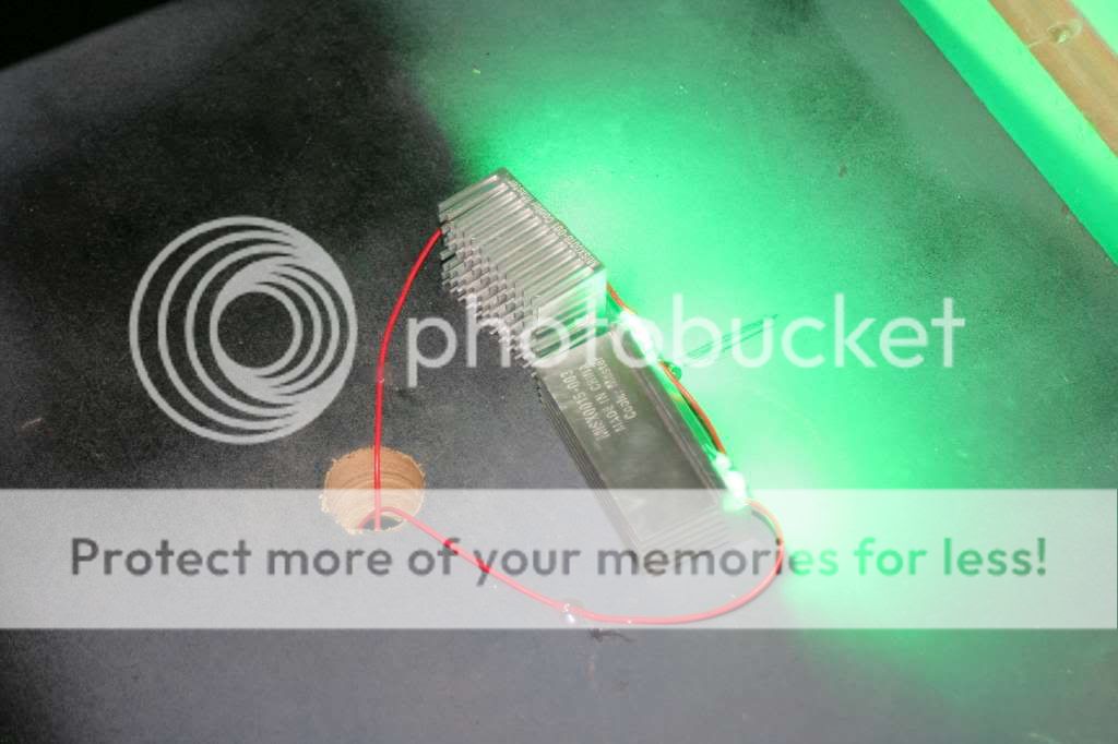

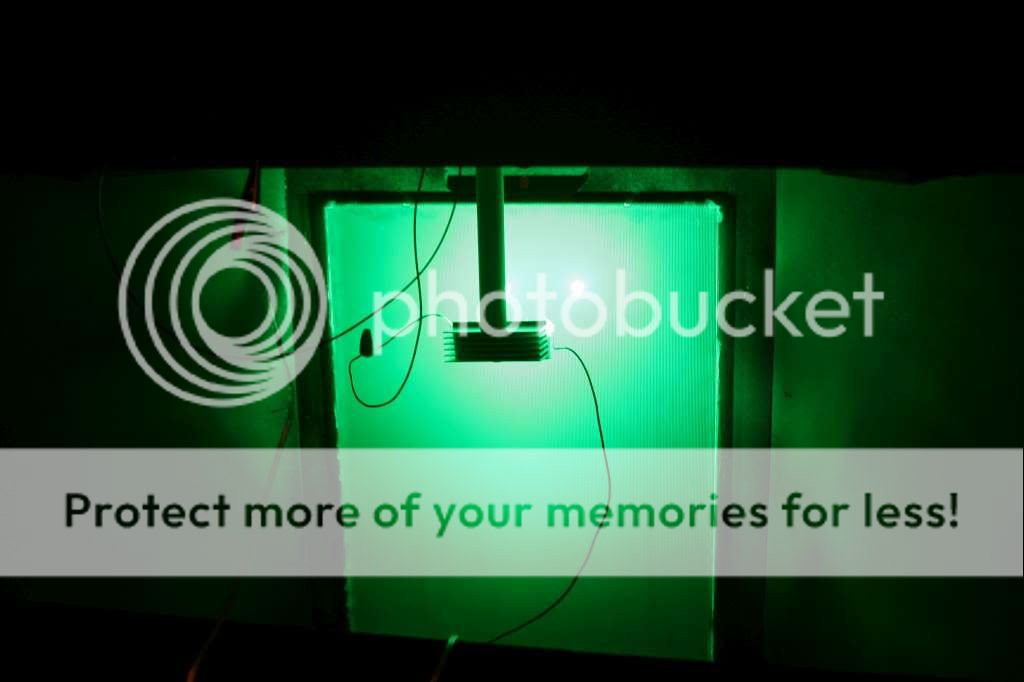

I'm working on a 4-player arcade pedestal. I need to power 4 1W LEDs and I would like to power them from the xbox so that they work easily switching with the xobx itself. Anyway, I am going to underpower them and run the 4 in series which requires 10 volts and a total of about 2 Watts. I first thought I could just power them from the DVD drive power but now I am wondering if that is going to have some negative effects on the DVD drive. Any thoughts? Should I power from the yellow wire from the DVD or try to tap in somewhere closer to the motherboard?
Here's a picture of the control panel lit up.

I was able to find an LED driver for $3.30Link Here, the only bad thing is that it is coming from china so 2-3 weeks air post. Oh well, I can wire everything up and use my bench supply for the time being to get everything dialed in. I'll use a relay from the +5V rail on the xbox to power on and off the LED driver when the xbox is running.
Here's a whole bunch more pictures. It won't have a spinner or trackball, just joystick and push buttons. It is running coinops 2. The joysticks are wired to hacked xbox controllers, 1 per setup which simply plug into the xbox.
