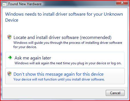

However, when I inserted a memory card into the controller, it said Unknown Device and began searching for additional drivers. It could not find drivers for the memory card, and so my memory card never showed up in Action Replay. Surely this is a rookie error, and I know it doesn't bode well since this is the very first step one takes on one's modding journey -- but I promise I'll get better if you can just help me figure this out.

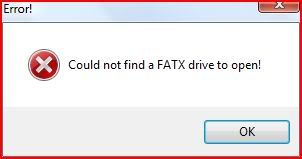

It is my understanding that I can also transfer files to the memory card from the computer when I have the card inserted into a controller that is connected to my computer via this device. However, when I tried to do this using Action Replay, it didn't recognize my memory card. It could not get the drivers for the memory card for some reason. This is to say, the Super Joy Box 11 worked fine without a memory card inserted. I was able to download the drivers for it from the manufacturers website. However, once I inserted an XBox memory card, I got the "searching for drivers" message once again, and after a few minutes the search game up empty. I then started this thread, and was told to try XPlorer360 beta 6 because "it doesn't need drivers". But I seem to have the same problem with XPlorer 360, as I get this message.....

Xplorer360 doesn't need drivers, and that error message has nothing to do with drivers, as it says quite clearly. It says it can't find a FATX drive to open - in other words, it can't see your memory card.
You have formatted the memory card in your Xbox and confirmed that it works properly, haven't you?

OK, but I still get this message when I insert the memory card into the XBox controller that is connected to my PC via the Super Joy Box.....
You say that I don't need drivers, so I can just ignore that message? And any idea why Xplorer360 can't find my memory card?? I have checked the cards and wiped them clean, still nothing.

It's looking for a driver for the memory card. Since AR and Xplorer360 give you the same error, your only option is to try a different memory card.

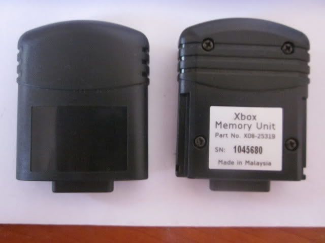

So if it is indeed a memory card issue, what kind of memory card will I need to purchase? I assume a Microsoft XBox original is best, but is that not what I have here? Or did I unwittingly get cheap imitations with my 2nd hand Xbox?

The cards in the picture appear to be xbox MU's.
Try this: Plug one of your MU's into your xbox controller. Then plug the controller into the xbox. Go into the memory section of the dash and look to see if there are any game saves on your xbox hard drive. If so, copy one of them (any one) from your xbox HD to your memory card. Once you have a save copied to the memory unit, unplug the controller from the xbox and plug it back into your PC. Ignore the driver error message on the MU and open Xplorer360. When the program opens, check to see now if you can open your memory card.
