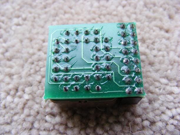

I thought it might be useful to include a couple of photos so that someone might be able to comfirm the modchip. I don't see any switches that allow configuration etc...
Does this help and can you help?
thanks

What made you think that was an Xecuter 2 chip........?
It isn't, and you need a second, working chip so you can boot with the second chip, hotswap the current chip, and reflash it with a working BIOS.

Well - I believe its using an Xecuter 2 chip as it used to display "Xecuter 2" in small writing at the bottom of the boot screen. However - I know nothing about modchips (apart from how to flash them incorrectly!!)
I've decided that I have little or no chance of fixed this.
I've managed to get my xbox to boot by disabling the modchip and rebuilding the hard drive using xboxhdmaker (luckily I had an eeprom backup). I've then performed a soft mod, so I am at least back running unsigned code. I do now have to worry about locking the hard drive, but its a significant step forward from Christmas lights!!
Thanks for all comments - its been much appreciated.

well like i said if your in the uk, and feel like getting it reflashed feel free to send it over to me and il reflash it for you..
And it said xecuter 2 at the bottom because it was using that bios..
its not specifically chip related..
However again..
you can tsop flash that xbox without soldering if you get a conductive ink pen.
but if your happy with softmod then your ok as you are.
