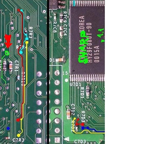

davicoro
Aug 27 2004, 03:32 AM
someone ask for this!!!
Just make two bridge
one from blue to red and other from yellow to skyblue
bridge the Sharp point to vcc

powerpak
Aug 29 2004, 03:54 AM
sorry, but I was wondering what the points in these pictures are for. I am looking for some alternate points for some TSOP flash fixing.
davicoro
Aug 29 2004, 06:15 AM
| QUOTE (powerpak @ Aug 29 2004, 04:57 AM) |
| sorry, but I was wondering what the points in these pictures are for. I am looking for some alternate points for some TSOP flash fixing. |
this pic show all the alternate points followes by colors... for example. the two points that you usually use on top of mobo 1.0-1.1, one is mark in red and the other one in blue... just sellect one point in the red line and other one in the blue one and make a bridge.
the same apply for yellow and skyblue
boowhup
Aug 30 2004, 12:04 AM
Excellent stuff davi
Just to make sure i'm right, I can choose anywhere on the blue lines to any where on the red lines correct?
And anywhere on the yellow lines to anywhere on the skyblue lines?

slipperysnowman
Aug 30 2004, 10:31 AM
Is there a need to bridge a third point? On the underside of the board..I'm working on a 1.4 with a winbound 232928401 . I keep getting 0x09 even though I've got everything bridged...gonna try this..thanks.
slipperysnowman
Aug 30 2004, 11:04 AM
used the pic...made a bridge...worked like a charm...

magneto
Aug 30 2004, 11:11 PM
OMG! Thank you SOOOOOOOOO MUCH for this post. I also had the exact same problem with the winbond (1.5) and the solder points in slushies guide do not work. I kept recieved the same error as did Sliperysnowman in this thread.
To the author or whoever made this, I can't thank you enough.
I still have to finish the board with a bridge, but these images acutally are identical to older boards.

TomT
Sep 2 2004, 06:48 PM
davicoro,
THIS IS GREAT ... THANKS ... if I only had seen it before :-/
I wired a V 1.1 with a SHARP TSOP ... where (supposedly?) a 3rd wire on the back is needed... for flashing.
Everything went OK until I reinstalled the Board and the 3rd wire (the one only for SHARP)
got stuck and pulled a trace of wire
(The part I dotted in green)
Luckily the Box still works <sigh> ...
but of course I cannot flash it :-(
CAN ANYONE HELP in pointing to an alternate location ?
CAN ANYONE give advice as to what this trace actually connects?

davicoro
Sep 2 2004, 11:36 PM
Updated!!!
added the sharp line point... join it to vcc

Ecct
Sep 20 2004, 07:13 PM
Hey i have a quick question, i have a 1.1 xbox i'm dealin with and it needs a sharp flash, now can i just bridge the little leg on the tsop chip to the point on the first left picture... or do i need to connect the bottom pink section to the top pink section.... i'm just a little confused on that...
i got the 2 main point jumped, but for the sharp one of the ponts is gone, is there any way to replace it? the track just goes to nothing... i'm not sure if i'm explaning myself well enough. hmmm but if anyone has any idea lemme know, i'll try to get some pics.

davicoro
Oct 2 2004, 07:33 PM
| QUOTE (SICKdimension @ Oct 2 2004, 08:41 AM) |
| When you wire up a jumper wire, does it have to remain connected permanently, or is it just used for flashing? |
the wires are only to flash the tsop... once you flash the chip you can remove the wires

neonman
Oct 6 2004, 02:17 PM
on the 1.0/1.1 xbox, isnt it true that the sky blue line can be connected to the other 2 pins toward the edge of the TSOP? I think i saw that they werent connected in a "Flash TSOP With matrix modchip tutorial. If im right, i think it would be easier to solder for those of us without expensive soldering irons. Can anyone verify this?

Oct 8 2004, 12:35 AM
awesome, thanks for the pics.
I ruined the R7D2 points on a 1.5 box I was doing for a co worker, and connected the two open holes listed above with window defogger goop, and it worked like a champ.

pilto
Oct 14 2004, 08:44 AM
Great pix... Question though... I lifted the pad from r7r4 for a sharp tsop by accident.... Now, looking at the pic, it looks like I don't need to connect r7r4 to c7r3 (they appear to already be bridged...) Am i missing something... if so.. where should i connect c7r3 to? Thank you.
pilto
Oct 14 2004, 09:22 AM
Lol... N/M... the points in the tut i have are electrically the same (don't know why it insists on connecting a wire, but oh well...) heh.. i just missed the pic of the wire needed for the sharp tsop... lol...

mixman101
Oct 23 2004, 12:17 AM
Thanks for this, I accidentally ripped of the red to yellow bridge below the TSOP and couldn't see the traces. I know, I'm retarded.

sharon
Dec 8 2004, 09:28 PM
This should be pinned for anyone who use nail-clippers to clean solders.
I wanted to clip off the solder on my original point and stripped the whole area...I was looking for an alt point and here is the answer. Someone helped me out with your post.

johnt
Jan 27 2005, 06:22 PM
QUOTE(davicoro @ Sep 1 2004, 11:25 PM)
as i can see this one help some people... i will update it if i found other points to bridge
pin!!!
This is wicked, saved me a lot of trouble. I tried to solder a wire between the two points in slushie's guide but the ended up pulling the track off - this is much much better.

maLniveK
Feb 18 2005, 06:02 PM
This is so great!!!
I messed up the points posted on the original tut and also lifted 1 bottom trace. let see if i use alt points in this guide will it work?
thanks
Leafz
Feb 19 2005, 03:11 AM
QUOTE(maLniveK @ Feb 18 2005, 11:08 AM)
This is so great!!!
thanks
Does your xbox boot normal? If it does try the Alt points and retry to flash.
Good Luck
maLniveK
Feb 22 2005, 08:40 PM
yea it's working like a charm now...thanx to this post
