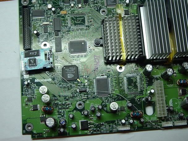

Nugwin
Jan 21 2006, 03:40 AM
heres my install:
my lite is installed in the correct position, the d0 from the chip goes to the top d0 point on the motherboard. the BT on the chip goes to the BT on the bottom of the motherboard. the top picture on
this site is where i soldered my BT because the eject BT doesnt work.
Ill get a few pictures in a minute.

ok , im no picasso lol , but see if this makes it easier to understand
Nugwin
Jan 21 2006, 04:43 AM
picture 1 is the modchip install
picture 2 is the d0
picture 3 is the alt Bt
picture 4 is the alt bt.
sorry for 3&4 its kinda hard to see.

Julius Pleaser
Jan 21 2006, 05:16 AM
LOL. I think you are confused. YOU SUCCESSFULLY MODDED YOUR BOX. It shows your hacked bios loading (I am 99% sure it said Xecuter at the bottom of the boot logo rather than MS). If you don't install another dashboard it goes to the MS DASHboard by default. SO get yourself a CD like Slayers Auto Installer and load a dashboard onto your box and you are good to go.
