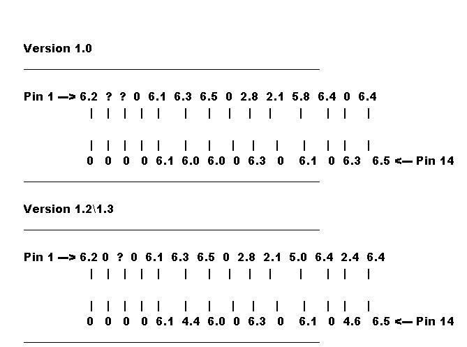

mstandlee
Sep 16 2006, 04:27 AM
Ok, Just checked my pic chip against a 1.2/1.3 I found some different readings.. Here's what I found
This is a broken motherboard that I tried a ram upgrade on. The ? marks means the voltage kept jumping and was unreadable. I am wondering if this is the reason my broken 1.2/1.3 motherboard is not working, becuase I had a short and it fried the pic chip. If anyone would test the pic on a working 1.0 and a 1.2\1.3 I would greatly appreciate it..

mstandlee
Sep 17 2006, 05:22 AM
Ok.. Just got the readouts off a working board. They look a little different.. ok alot different. Here they are:
What do you guy's think.. Is the pic chip fried or are they just different like this? Got maxx or A@ron, would love your input
Thanxs for any help,
mstandlee
Zebes
Sep 17 2006, 10:24 AM
pins 11 through 14 did have a reading
it was 0.12, 0.12, 0.13, 0.14
also, pin 8 had a reading of 4.7, i think, for about 2 seconds on power up, and 0 after that
