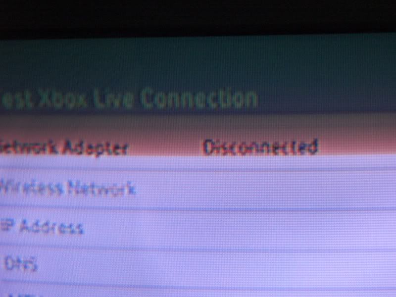

I have tested the connection to XBL and theres no response on the first step. It says not connected for Network adapter but my router is connected 100% and is working because my regular xbox and computer can network and go online. It won't even show if there is connectivity on the router to the 360 and no luck, so I know that its the box. Is there anyway I can fix this? DO you think that it might be internal? If so, where on the mother board is the Common parts that fry or break down for the ethernet port so I can solder it.

well yeah, i tried using a different cord and still it fails to connect on the first step. I even tried connecting through a direct connection to my motorola surfboard modem. Well here are some pictures of the tv on the first step. any ideas?
Morlok8k
ok: run the test, click [More Info], Press (Y). then tell us the WXYZ codes.
