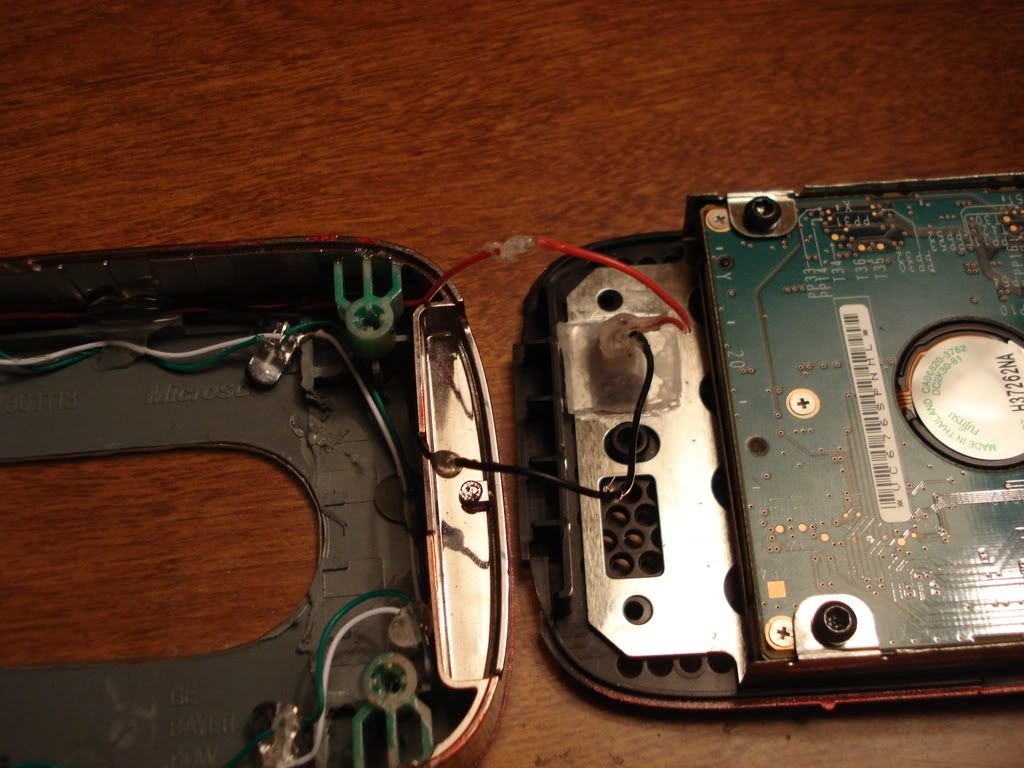

I had an idea for a mod and i dont think anybody has tried it what i want to do i hook my pulse vu 2x up to the leds in my Hdd i know this has an issue of the wires running into the hard drive so i came up with a simple solution a plug. im thinking that if i use a small plug like the ones use for the rumble motors in the controller it might work and recess it so that the whole plug is in the HDD but still able to unplug keeping the ability to remove the HDD. This idea came to me while i was at work so as soon as i got home i started to work on it here are some pics i got it installed and everything works ill put up a vid tomorrow

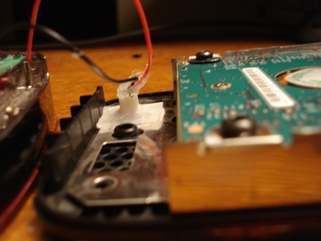

LED's in HDD
plug in HDD
Custom "bracket" aka peice of plactic to hold plug in HDD

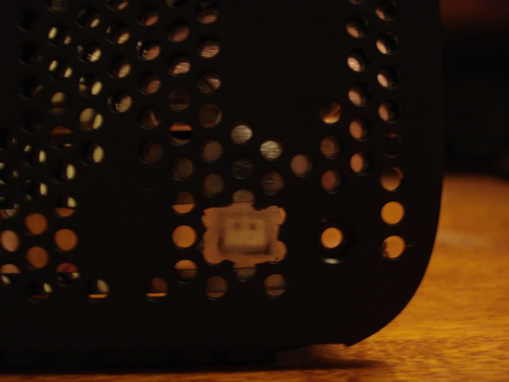

Plug on bottom of HDD housing

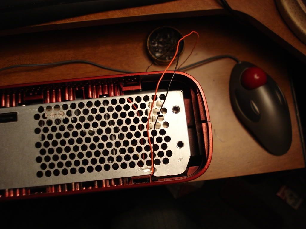

were i got the wire out of metal shield or whatever it is

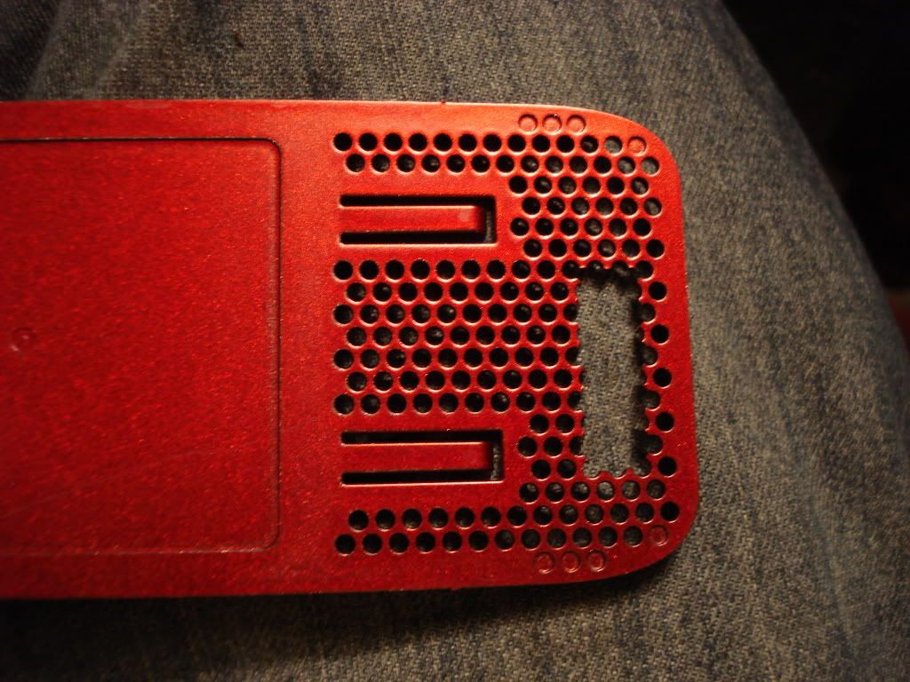

Cut out part of grill for plug to come throught and for extra wire to be stored

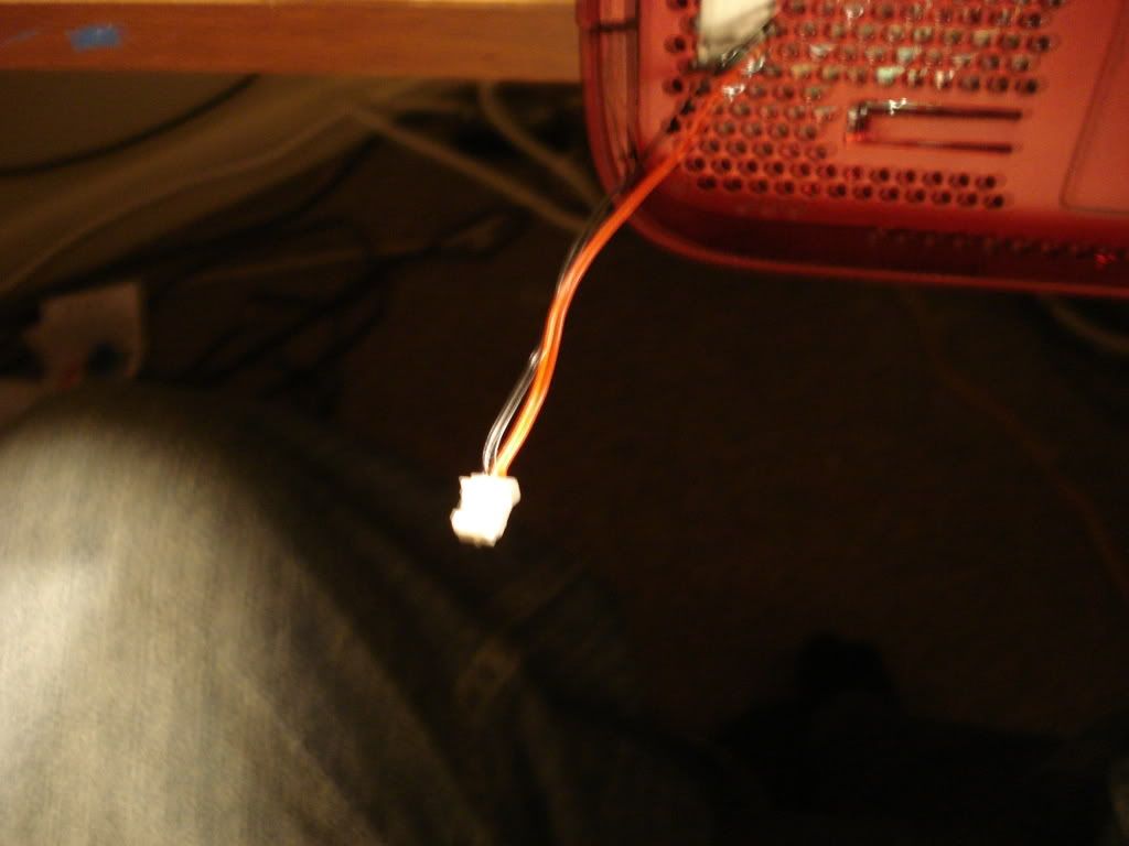

plug on end of wire coming from the console sorry for the blurry pic i couldnt get a good picture of this

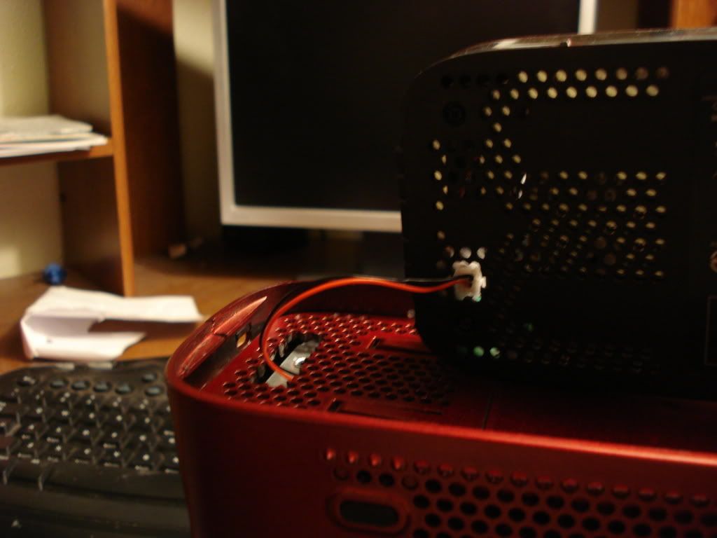

and everything plugged in
i had a minor problem with this when i plugged the hard drive into the console the lights would stay on instead of fade after a troubleshoting session i found that the ground wire from the pulse VU2X was being grounded to thhe metal housing inside the HDD a little hot glue and it was fine.
