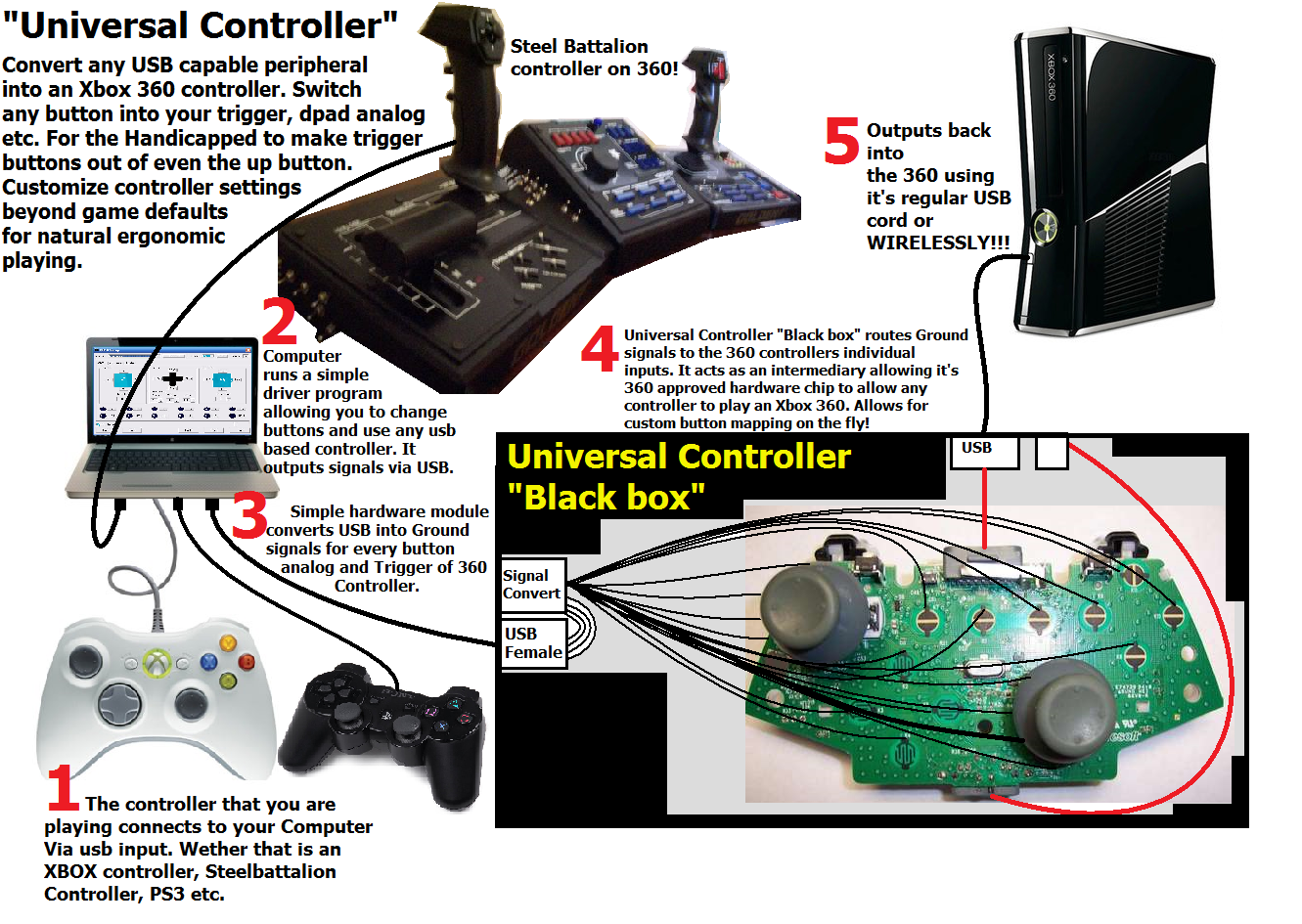

Robert-0137
Ben Heck; the guy who makes Xbox laptops and custom controllers for one or ZERO handed handicapped people, is doing a show where he's asking for submissions for projects to do that need to be done or could help people. http://benheck.com/benheck-project-submission
My idea started out because button mapping can be a hindrance to handicapped people who have use of one or no hands or are missing fingers. I had a friend who's Hummer got hit by an I.E.D. (he's perfectly fine) and the first thought he told me he had when he was checking himself was "I hope i can still play video games!"
Granted it's just a concept i submitted, but I had an idea so you could use any controller, PS3, 360, Steel Battalion, Vitrual On, etc on the 360 and change any button setting. The way it would work is by plugging any usb based controller into a computer, the computer runs a simple driver program allowing you to change any button and then sends those signals into an 360 controller PCB bypassing the 360 recognition chip and allowing any controller, rare or obscure to play. It would be more practical for the average handicapped person to have (easier to make so less cost) and useful to play on modded "One Handed Controllers" as well.
What do you think is the possibility of this being created? Maybe as your own next project?
People have programmed computers to use controllers to play Super Mario Brothers, and i think this concept has man feasible similarities.
