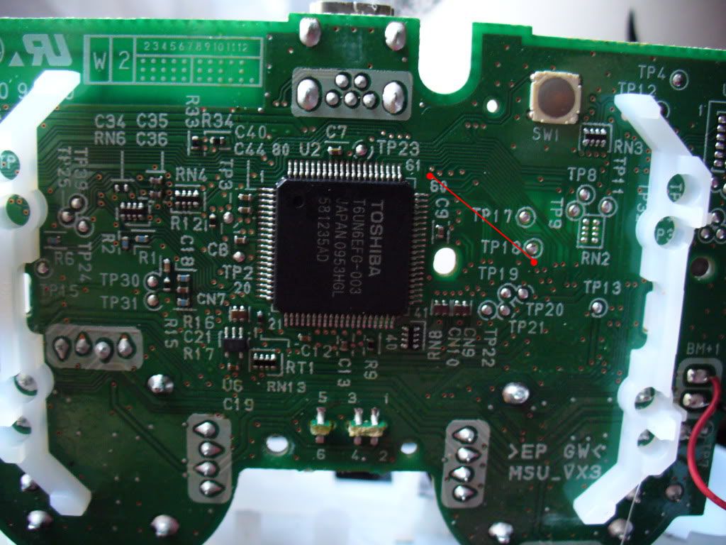

I recently bought a controller with custom mapping but i hate the analogs of that thing so i decided to add 2 extra buttons on my ps3 controller.
If anyone is so kind to give me a few pointers it would be much appreciated,here the pics:

You'll have to prep a couple of Vias to solder the X and O wires to, then you'll use TP18 for the common connection for them.
http://forums.xbox-scene.com/index.php?showtopic=648322
As far as the buttons go, that's a bit of personal preference, as long as you have the room for them and they are a Normally Open (N.O.) Momentary type you can really use whatever you like. The more common ones that are used are Tact switches like these. http://www.mouser.com/ProductDetail/ALPS/S...lxGEX2zSw%3d%3d

That's not what you should do at all.
You need to scrape the masking off of the Vias to solder to them on the back side of the board.
I personally wouldn't use conductive glue as it's going to conduct anywhere it gets on the board and you'd still need to prep the Via so there was copper to glue it to so it could conduct, so there's no real advantage to using it here. Practice soldering on something else first to get the hang of it, and make sure you use some 30awg wire.

My first reply has the link to the PS3 controller versions and TP spots (and Vias) thread, those are the best spots to use.

Slight problem,i managed to solder the vias but whem messing around with the t18 i managed to pull it out :s,this is a slighty faulty controllers and i'm using for testing.its the tp18 very important?will my controller not work?
I will start working on a new DS3 anyway.
Lifting most any TP spot, trace and certainly Via isn't ever a good thing. If you would lift the TP18 spot of your controller (pics in first post) then that would kill the X, O, [ ], /\, R1 and R2 buttons until it was repaired.

Do you have any tips to fix this,i've tried but didn't have much luck sad.gif.

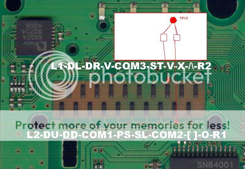

It depends on the controller version. If it's the one in your pics there then there are 2 Vias you can solder a jumper wire between and fix it, just trace out from the TP spot and you'll run into them.

Maybe I'm just dumb but I really can't figure out which two leads to bridge :/
I also accidently pulled out my TP18 while putting the back cover back on and I tried to follow the leads but both times I tried, the controller acted funny
btw, I have the same model controller.. if I could get help on this, it would be greatly appreciated
If you've pulled off the TP18 spot then you'll have to jumper over that and connect the Vias at each end of that trace run, something that will be much more difficult than soldering to the TP18 spot.
ktowntx41
so before I go soldering blindly like I think I may have already, would this be the correct place to jump?
/edit: sorry for edit, but if I do bridge them, do I connect a wire to this new wire in order to hook to a button? I feel like there's something I'm missing here for some reason and sorry for being such a noob, I've never pulled out a COM before :/
Yes, exactly.
