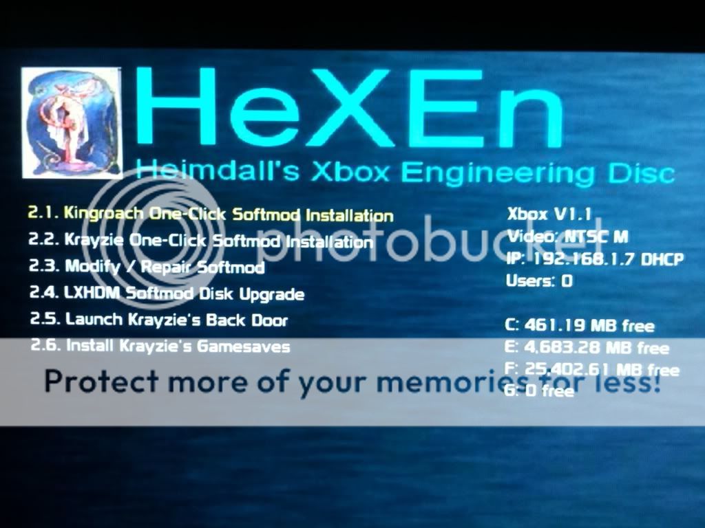

jammin0
Ok, I'm at this point and not really sure which option to choose. I'm really paranoid about screwing up this guys xbox, if it were my own I think I would just guess and see what happens. He has an upgraded harddrive. If I update the softmod will it do anything to his savegames or his games/apps that he already has on there?

If it doesn't then use HeXEn. It won't mess up his games / apps. It will delete any gamesaves for Splinter Cell, Mechassault and 007:Agent Under Fire, but leaves all other gamesaves untouched. It installs UnleashX as its dash, but gives you the option to switch to Evox.
You select either 2.1.2 to install a Kingroach softmod, or one of options 2.2.5-2.2.7 to install a Krayzie softmod. If your friend still has 007:AUF I'd suggest you use that option (2.2.5), if not then use option 2.2.7 (Splinter Cell) because all copies of Splinter Cell are exploitable and you can pick them up for pennies. Don't worry, you don't need the game to do the upgrade, it's just a useful back door for the future.
Once Krayzie is installed and working you reboot with HeXEn and select option 6.2 to enable the HD modes.

Perfect, worked just as advertised, the enigmah hung on me but I was already in NTSC mode so I finally rebooted and it kicked me over into MSDash to change settings. The one thing that didn't quite work was the XBMC link. I'm not quite sure what happened, my buddy has all his apps on the F: drive. Can I just copy that over to E: to get it working? Thanks a million man, Hexen disc sure was slick.
