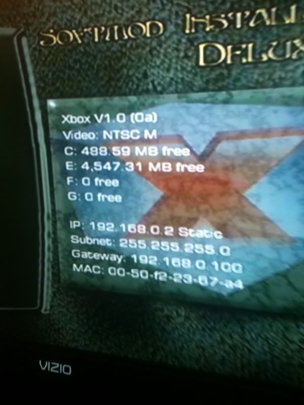

i softmodded my v1.0 Xbox with the splinter cell exploit and unleashx dash. I have my xbox crossover cable with m y PC. My xbox and computer is hooked up to the tv so i have a short Ethernet cable with my xbox networked on top of my tower. i enter the static ip adress on filezilla and flash fxp, and still cant connect. it shows unidentified network on my computer. but i just can't figure this out.

What is the Xbox static IP address?
What is the PC static IP address?
Can you ping the Xbox from the PC?

What about the other questions? Your screen shots only answer one of them.

Once you've checked the network LEDs on the Xbox and PC, the most likely cause of your problem is that you haven't set an appropriate static IP address in your PC. The security settings on your PC might also cause problems, but sort out the IP address first.
