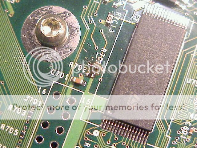

shambles1980
if yours has a tsop chip near the LPC header then yes you can follow the guide generally..
if yours does not have a tsop chip then its a 1.6 and has to use a 1.6 psu.
here is a image of a tsop chip near the lpc header.
the tsop is the big black thing with little silver legs.
image stolen from google.
