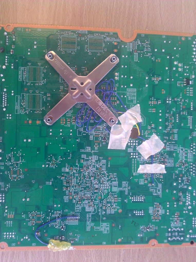

So I opened the slim to adjust the CPU RST wire and I saw this
Whats with the extra cable on the side? The RGH TUT I have doesnt show it like that? Could that be whats making it freeze?
Is it a repair?

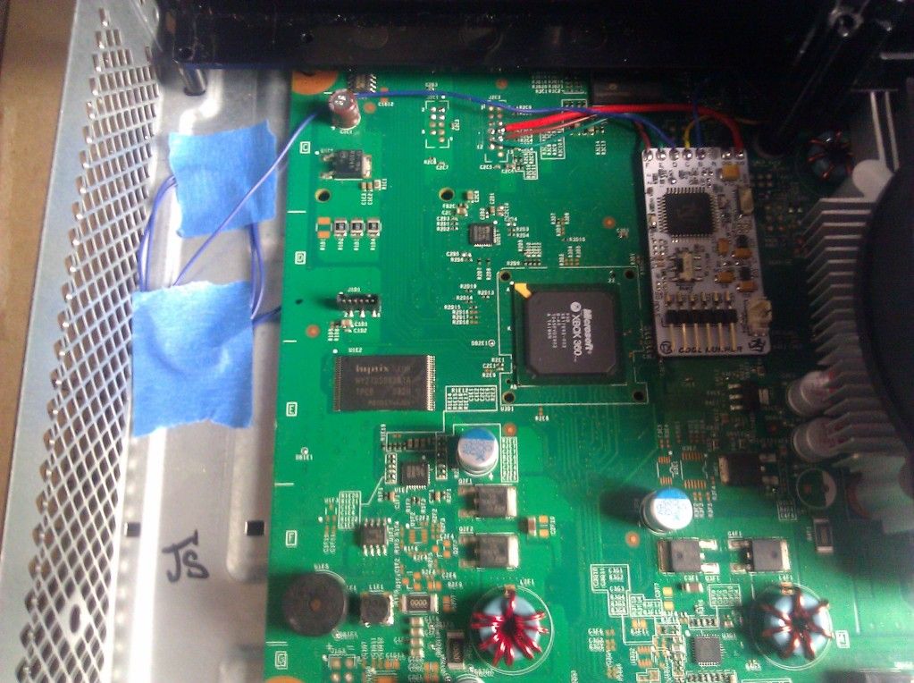

boflc
Jul 25 2012, 03:38 PM
can you take a similar picture of the top side, please?
vicicarus
Jul 25 2012, 06:13 PM
vicicarus
Jul 25 2012, 06:40 PM

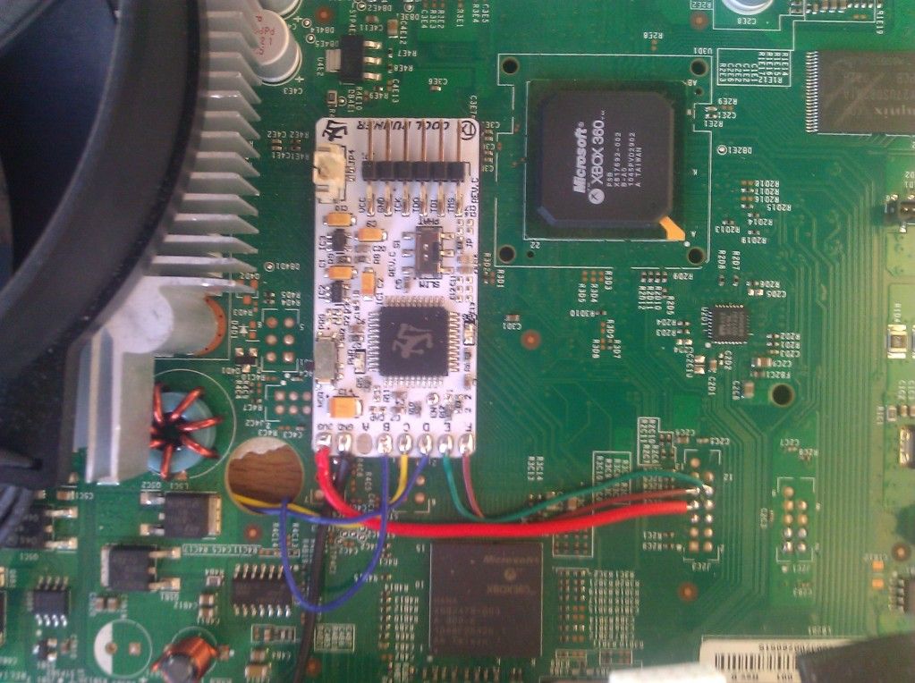

here is another one just in case you need a close up off coolrunner and side wire,
GOTitCUZiMODDED
Jul 26 2012, 10:11 AM
I've got a few of these in the past month and they all needed a reflow after no luck resoldering or hitting the wire length sweetspot. They all would also freeze with checkerboard screens (seen plenty of these in Xenons). The wire can work in that spot, but it's best to coil and tuck it back in or run it around the 4x xclamp posts. Please post your results.

honestly I do not how it even would ever work like that. Whoever sold it to you is an idiot. the wire coiled up like that is messed up and unprofessional looking. It's a time bomb. I don't know what the wire on the side is about. I've done 15 slims already. And they all boot within 10-30 seconds. I think only 1 or 2 took >1 min to boot. but, all the slims I've done do boot eventually. Good luck buddy.

third: FT1T7: this is a nand point for a cygnos install. i /think/ i can see that the others were also soldered to. don't know, but either it was a failed cygnos install /or/ a removed cygnos install. why the hell FT1T7 is soldered to ground, i don't know. (at least, it appears to be grounded on the edge plane). i don't think this'd cause it, but i don't have a schematic handy to map that point from, say, a xenon to a slim. maybe someone with a little time can check the schematic and reply.
finally: again, i haven't seen the freezing on a slim: the checkerboarding is particularly concerning, and i'm wondering (out loud) if it is the beginning of a hardware failure and would require repair.

With all that crap done to the board I'd doubt it was a BGA failure but it's possible.
I would first address that long blue CPU RST wire stuffed under the x-clamp. I would desolder it from the coolrunner, untangle it under the board and run it outside the steel cage. either make a hole or use the screw hole (don't use the screw) near the bottom solder point. As you put the board back in the cage, feed all the wire out to the bottom of the cage. Coil it up on the bottom somewhere leaving just enough to run to the left side and through a vent hole to the coolrunner. I'd also relocate the coolrunner to the far left side by the NAND chip. Once it's working good you can also cover the outside CPU RST wire with foil and tape, shielding it even more. That should at least fix any CPU interference.

I had a guy check out all the soldering points and since I got a copy of the original nand he also re-flashed it again using J Runner program. He coiled the CPU_RST wire under the mother board as show on tutorials and the system now doesn't go black but, what was discovered was that the front USB port might be loose or messed up, they still give the checkered design from time to time as long as I don't use then they don't mess up. I plugged in USB devices(control or flash drives) on the back USB ports of the system and those don't checkered up.Sooooo at the end it was a couple of things going on at once.
And the last thing I will say is that the side cable it has under the silicone or glue there was a Ohm resistor like the kind you would see on a phat jtag setup????????? it was taken off with no affect to the system???????
